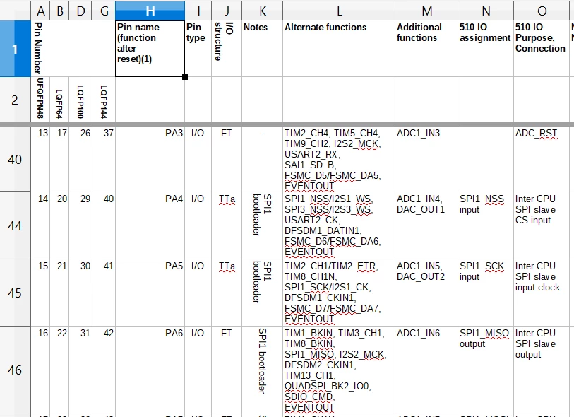

    @Stan0402​ - If only ST would provide data in spreadsheet form, it would help us a lot!
    Here's what I do:
    1. use the Tabula utility to extract the table from the datasheet PDF into CSV
    2. fix up the headers in CSV with an editor
    3. import CSV into a spreadsheet.
    4. hide rows pertaining to pins not present in the package we're using
    5. change background to red for all resreved pins (power, swd, crystal, etc)
    Its very annoying!
    Hope that helps,
    Best Regards, Dave

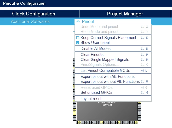

    Using STM32CubeMX, you should be able to export the pinout to a csv file:
    -Amel

    Thanks @Amel NASRI​ but that is not quite what we need. Especially when trying to determine which package to use, we need something more like the table in the datasheets. Also when trying to prototype with a large package (for example on Nucleo) for a product that will use a smaller package, we need all variants in one sheet. Example below,
    Thanks,
    Best Regards, Dave
    PS: Prototyping with Nucelo and building product with a different (usually smaller package is a reason you have so very many requests to make it easy to change selected package within CubeMX!

    MikeDB
    Senior II
    February 20, 2019
    I exported the datasheet PDF to a Word file and then the pin assignments are in a table which is editable. It's a bit wonky in places but can be tidied up quite quickly and then exported to Excel. This is what I ended up with as I just wanted the SAI pins.
