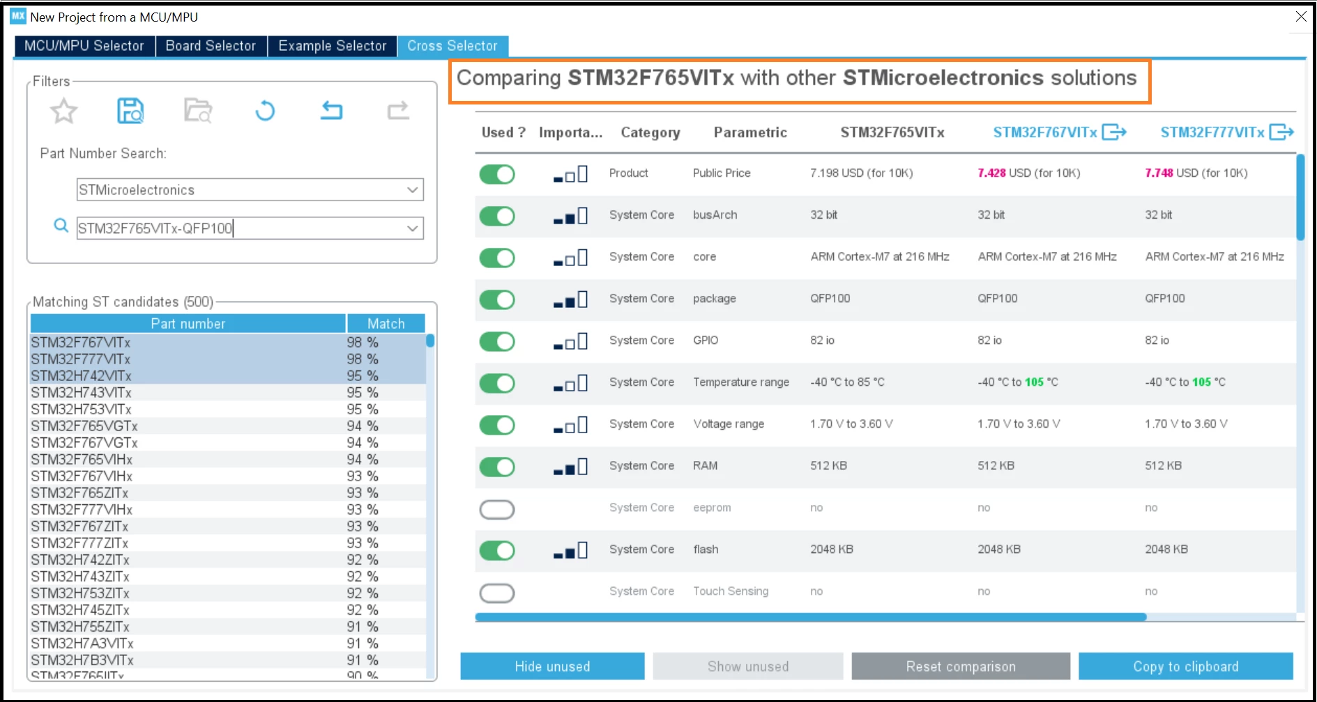

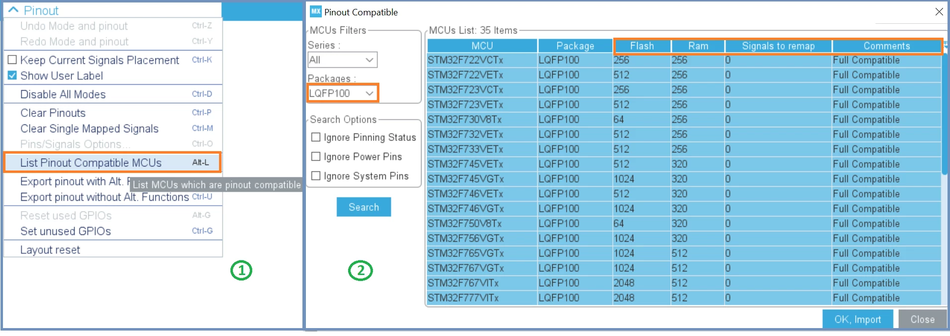

As mentioned by @Community member​ , CubeMX allows you to know the list of MCUs with Pinout compatible, you just need to start by creating a new project using your MCU part number (STM32F765VIT6 in your case) and press ALT+L to get the list of all compatible MCUs as presented in the image below:
0693W000007Z7vMQAS.pngIn addition to that, CubeMX offers to their users a way to compare two or more MCUs and all that under the Cross Selector:
Hope my answer helped you, when your question is answered, please close this topic by choosing Select as Best. This will help other users find that answer faster.
