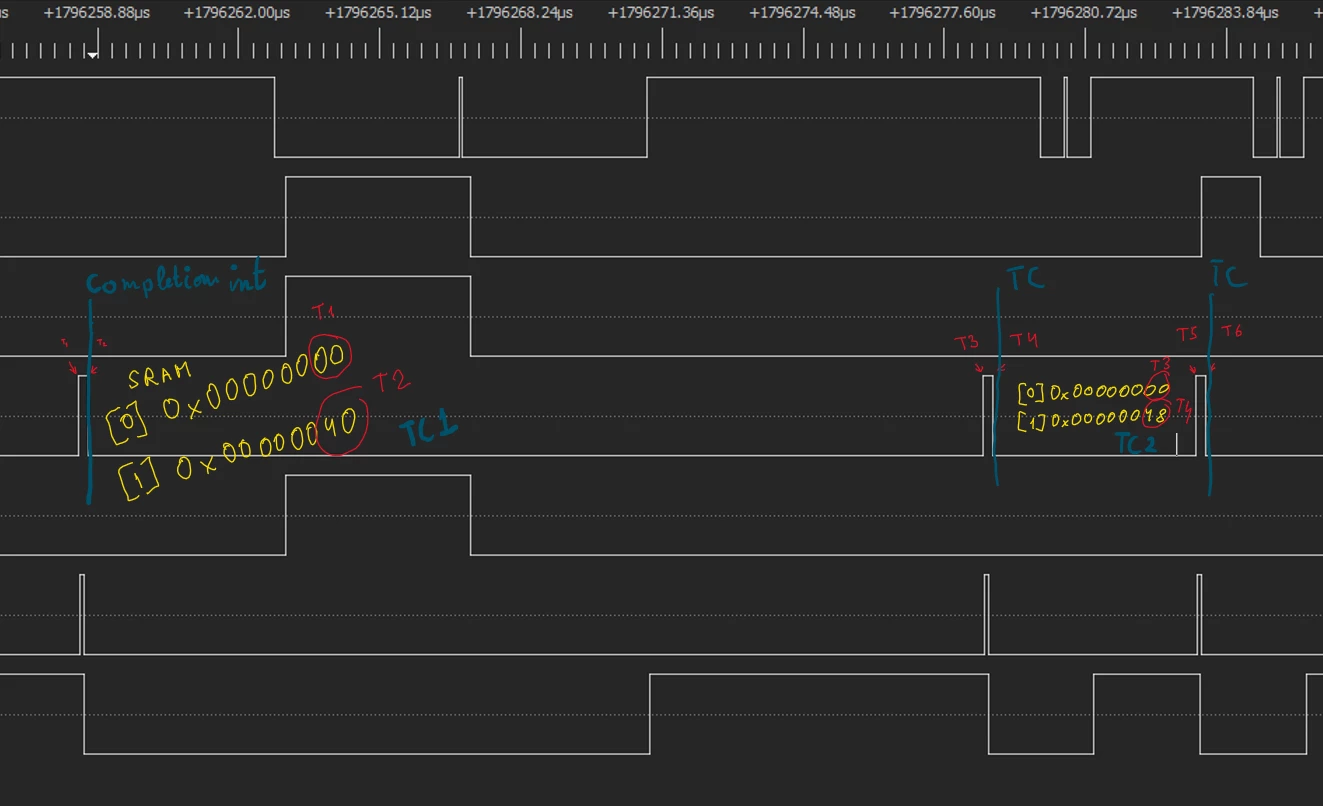

Thanks Tesla DeLorean for the helpful input. I realize I should have put up some signal form just to explain what I was after.
Summarizing my issue and solution:
  1. I was struggling to understand how the looping (of circular mode) was being handled through the HAL API. The most important part I missed is that the HAL_DMA_Start_IT(Channel, Output, Input, **DATALENGTH**); is talking about the size of the output location, which is directly stuffed into the DMA NDTR register.
  2. The circular mode being triggered off an EXTI interrupt means that "PeriphDataAlignment" will be read "dmamux_ReqGenParams.RequestNumber" times per interrupt. What I missed here is again related to point 1, datalength (aka NDTR) controls the warp around point of the DMA output. Which I initially thought to be controlled by "dmamux_ReqGenParams.RequestNumber".
Fixes:
  1. Changed the datalength to be 2, as I want the completion interrupt only when 2 values have been read. I don't need the halfway interrupt.
  2. Set request to back to 1. Because each edge just needs to trigger 1 read.
  3. Went back to a single buffer, as I have ample time to use the values in sram.
Here is the currently working init and a picture that explains the data collected for portA

Tesla DeLorean
Guru
August 31, 2022
DMA should be viable over quite significant buffer sizes
In circular mode DMA continues, but be agile, it's not going to wait for you.
Pick a size such that the interrupt can do it's work and leave within the time it takes to fill one half of the ping-pong buffer arrangement, and have the HT and TC IRQ handle the inactive portion of the buffer.
On CM7 make sure you properly manage cache coherency, the DMA units looks/changes actual memory, not stuff you have in the cache or floating in the write buffers.
Don't use the stack for DMA buffers, the memory is transitory, the DMA is less so

VN.2Author
August 31, 2022
a
I am doing CleanInvalidate Dcache on the sram address that I am attempting to read. I've added the below testcode to illustrate the setup and the interrupts.
I'm only seeing PortABuffer being filled with 4 words, even if I set dmamux_ReqGenParams.RequestNumber to 32. This is done by inspecting PortABuffer through GDB "x PortABuffer[4]".PortABuffer[0] to PortABuffer[3] show reasonable data PortABuffer[4] is complete garbage.
Since you say circular continues, should it continue even if no subsequent trigger occurs, or does it wait for the trigger always, or should I be using normal mode instead?
I swapped the stack vars with some logging to ram. I understand stack is transient but was more concerned with the fact that the cm7 was moving those.

VN.2
VN.2AuthorBest answer
September 1, 2022
Fixes:
