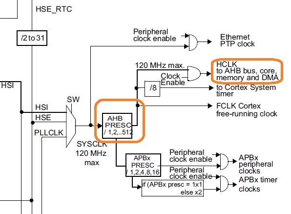

i am using STM32f207
i have a flash memory connected to SPI2.  I used the ST examples and i got it working, read/write, .. great, ... the problem is the speed ... how fast can i run SPI2?
There is a setting SPI_InitStruct.SPI_BaudRatePrescaler and the lowest value is SPI_BaudRatePrescaler_2
In my SetSysClock function i set the dividers to 1:  http://prntscr.com/3lbcy6
This should give me the fastest speed?
My flash goes up to 85MHz and i need to go at least 80MHz because there is a lot of data to read in short time .. will this be possible on SPI2?  I have a 25MHz xtal on the board and i am running the ST at 120MHz via PLL.

    In my SetSysClock function i set the dividers to 1:  This should give me the fastest speed?
    Wouldn't it just break the buses? APB1 has a max of 30 MHz, APB2 60 MHz
    For faster flash interfacing consider SDIO

    about breaking the busses, HCLK is the xtal freq right? so 25mhz will not break ahb1 if i set the ahb1 divider to 1?
    Tesla DeLorean
    Guru
    May 21, 2014
    Posted on May 21, 2014 at 23:11
    can i connect SPI2 to AHB2?
    I'm not sure how you plan on achieving that without reworking the silicon.
    No, it's the CPU (PLL) clock at 120 MHz, or a fraction thereof (1 .. 512). Review the clock tree
    You could bit bang the part, as you suggest, there are other 4-bit (quad) SPI Flash devices too

    From the DataSheet ...
    ''The STM32F20x devices feature up to three SPIs in slave and master modes in full-duplex
    and simplex communication modes. SPI1 can communicate at up to 30 Mbits/s, while SPI2
    and SPI3 can communicate at up to 15 Mbit/s.''
    Thus, even using all three channels simultaneously, the SPI hardware does not support the required throughput.

    Thank you i setup the clocks correctly now .. switched to SPI1 and all is good now thank you
