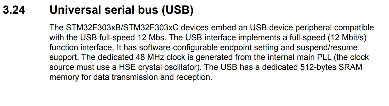

May 5, 2025 1:31 PM UTC
Hi @Umesh_Kumar278
First, external clock signal has to respect the I/O characteristics in Section 6.3.14 in datasheet
ADC clock does not have strict tolerance requirements like USB peripheral especially for audio class, but stable clocking is important for accurate conversions.
For USB FS, the dedicated 48 MHz clock is generated from the internal main PLL (the clock source must use a HSE crystal oscillator).
To comply with USB standard specifications, the tolerance for the HSE crystal oscillator used to generate the dedicated 48 MHz clock for USB peripherals is specified as you mentioned ±2500ppm.
