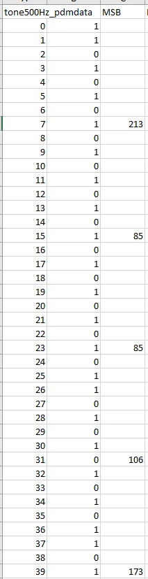

Firstly, instead of directly interfacing to a microphone or an ADC, I used sine PDM data from:
https://github.com/siorpaes/pdm_playground/blob/9aa442d8a7e3265fbcdbfb66111b8dbad301e928/pdmgenerator/Host/tones/pdm1MHz/tone500Hz.h
https://github.com/siorpaes/pdm_playground/blob/9aa442d8a7e3265fbcdbfb66111b8dbad301e928/pdmgenerator/Host/tones/pdm1MHz/tone500HzA4.h
tone500Hz = full scale single sine PDM data of 2000 bits
tone500HzA4 = lower amplitude single sine PDM data of 2000 bits
These are 2000bits of one sine cycle.
Also to get exactly the whole data of the 2000bits, with a decimation of 64, I multiplied it by 4 cycles, so I would get 8000bits. In effect, for decimator of 64, the PCM data output would be 125 (of 16bits).
I have arranged the PDM data bit in bytes with first data in MSB and have verified the data in excel sheet as shown.

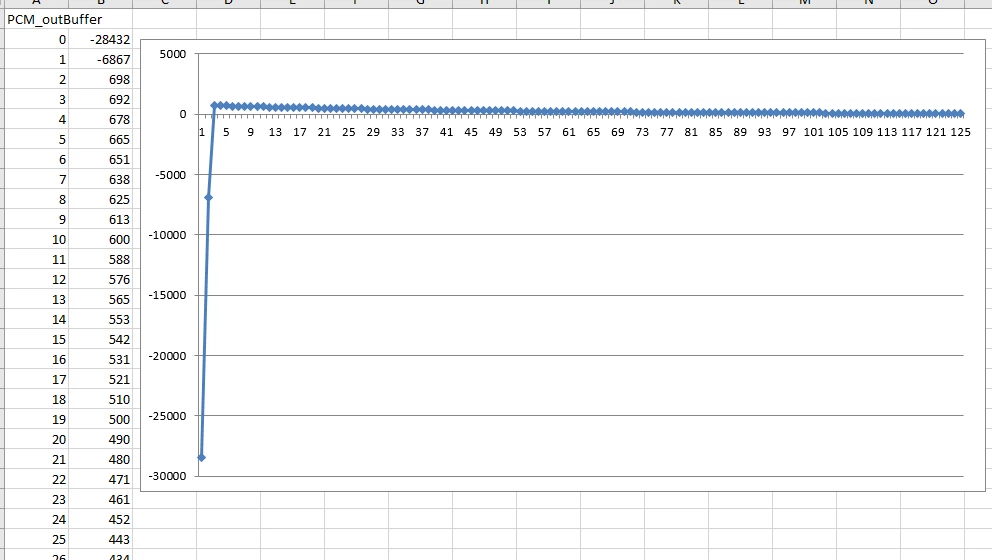

First I tried bytes of 0x55 and 0xAA to have a balanced density of 0s and 1s.
// first bit to MSB - 8bit tone "55 or AA"
for(uint16_t i = 0; i < sizeof(tone500HzA4_pdmdata) * 4; i++)
	pdmBuffer8_8000bits_1000bytes_1[i >> 3] = 0x55;
PDM_Filter(&pdmBuffer8_8000bits_1000bytes_1[0],&PCM_outBuffer[0], &PDM1_filter_handler);
printf("PCM_outBuffer \n");
for (uint16_t Index = 0; Index < 125; Index++)
	printf("%d %d\n",Index, PCM_outBuffer[Index]);
Then I have this data and waveform shown below. Please notice the first 2 converted PCM data.

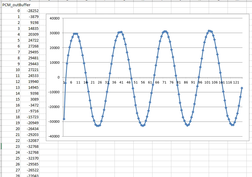

Second, I tried the full scale single cycle sine tone500Hz.h
// first bit to MSB - 8bit tone500Hz_pdmdata (full scale single sine PDM data)
for(uint16_t i = 0; i < sizeof(tone500Hz_pdmdata) * 4; i++)
	pdmBuffer8_8000bits_1000bytes_2[i >> 3] = (pdmBuffer8_8000bits_1000bytes_2[i >> 3] << 1) + tone500Hz_pdmdata[i % sizeof(tone500Hz_pdmdata)];
PDM_Filter(&pdmBuffer8_8000bits_1000bytes_2[0],&PCM_outBuffer[0], &PDM1_filter_handler);
Then I have this data and waveform. Please notice again the first 2 converted PCM data.

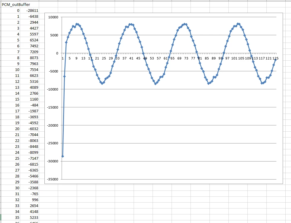

Third, I tried the single cycle sine tone500HzA4.h (a lower amplitude single cycle sine wave)
// first bit to MSB - 8bit tone500HzA4_pdmdata
	pdmBuffer8_8000bits_1000bytes_3[i >> 3] = (pdmBuffer8_8000bits_1000bytes_3[i >> 3] << 1) + tone500HzA4_pdmdata[i % sizeof(tone500HzA4_pdmdata)];
PDM_Filter(&pdmBuffer8_8000bits_1000bytes_3[0],&PCM_outBuffer[0], &PDM1_filter_handler);

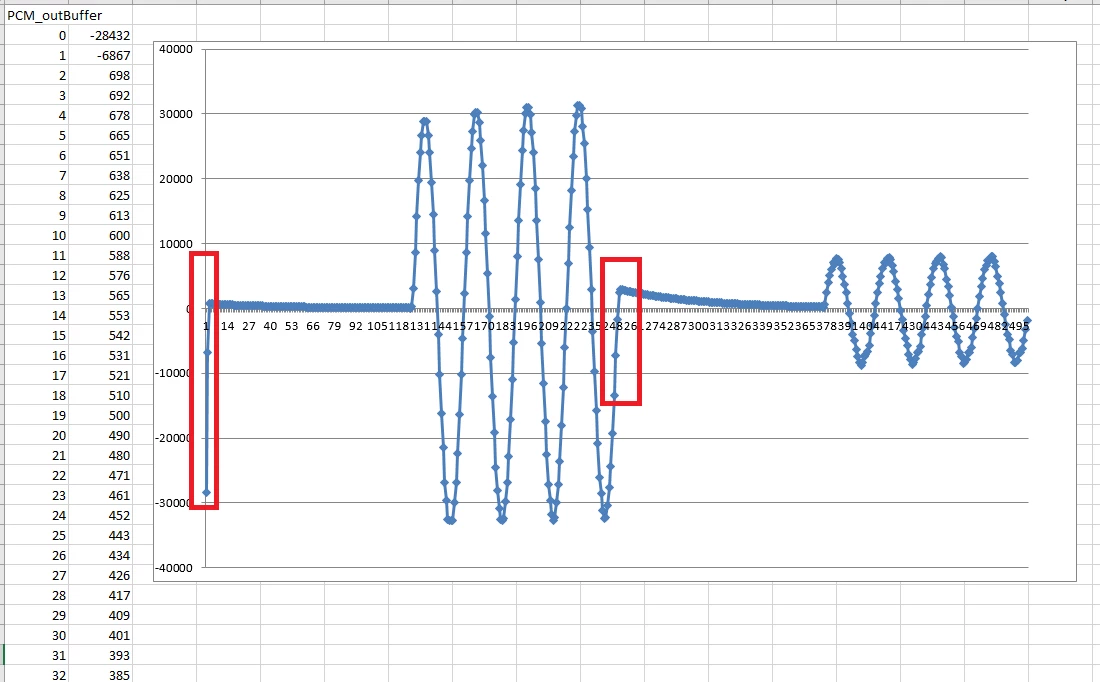

Fourth, I tried to combine the 3 PDM data in order stated below:
1. PDM data of 0x55
2. tone500Hz_pdmdata (full scale single sine PDM data)
3. PDM data of 0x55
4. tone500HzA4_pdmdata (lower amplitude single sine PDM data)
PDM_Filter(&pdmBuffer8_8000bits_1000bytes_2[0],&PCM_outBuffer[125], &PDM1_filter_handler);
PDM_Filter(&pdmBuffer8_8000bits_1000bytes_1[0],&PCM_outBuffer[250], &PDM1_filter_handler);
PDM_Filter(&pdmBuffer8_8000bits_1000bytes_3[0],&PCM_outBuffer[375], &PDM1_filter_handler);
for (uint16_t Index = 0; Index < 500; Index++)
Then I have this data/waveform.
Can you advice on the ff:
1. Are procedures all correct?
2. Is the first 2 PCM-converted data are correct and how to mitigate it?
3. Also on the 2nd red rectangle, I see also somewhat abnormality, how to validate if correct?
