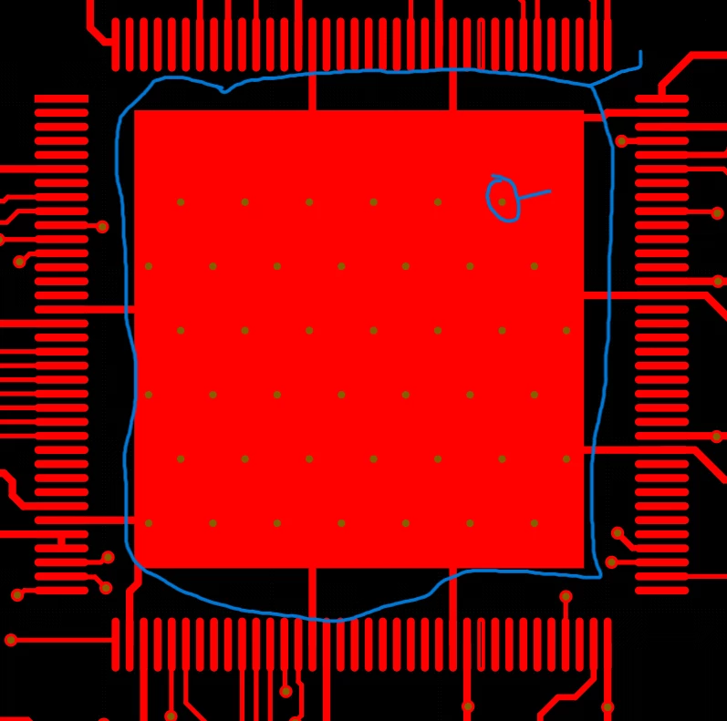

According to some reference it is good to have ground polygon under IC
1. Is it okay to have ground polygon under IC?
2. Does it effects heating issue?
3. I saw two hole behind the IC of nucleo 144 board. What that mean?

we do not have an exposed pad for this MCU and package , there is not real interest to have Ground polygon under the package . It will make your routing of other signals more complex . However this is interesting for segregation of Analog routing versus Digital high speed signals if applied close to that blocs .

look at this, this is none exposure gndst1.PNG polygons with gnd vias. You mean no need to add this polygons right?

yes, I confirm no real need , but it is good technique to have ground vias to other layers on PCB.

My designs are complex enough that I want to use 4 layer boards.  Top, ground plane, inner routing, and bottom routing,   On the top and bottom layer, I can use a polygon fill for VCC, which helps with current carrying capacity (some) and adds more stability.
I have, and can use 2 layer boards but that is on a board that is not densely packedd.  Say an L5 design with 100 pin packages and not a full load of peripherals.
No reason not to use a ground plane under the chip, but it will make routing more difficult.
Hope this helps

I am using 4 layer stack
1. Top layer
2. GND 1
3. GND 2
4. Bottom Layer
But I got your point . Thank you
