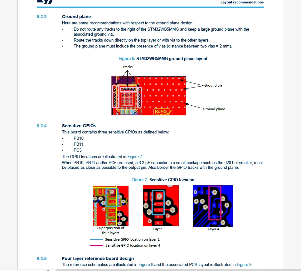

In the page 13 of the datasheet (https://www.st.com/resource/en/datasheet/stm32wb5mmg.pdf) there is limited information about the PCB layout guidlines.
I'd like to know more about the layout on left side of the module in the image shown if the modulle cannot be placed in the corner.
Also, what are the dimensions of the stitched ground plane on the right side of the module?
Is there a document which provides more detials about the PCB design guidlines?

To have more information about the PCB design of the STM32WB5MMG, you should take a look on the CAD RESOURCES of the chip.

Thanks for your reply. On the CAD resources page, I can only find IBIS/BSDL/SVD files. I'd like to know more about the layout guidelines to get the best RF performance.

You can take a look to the Schematic Pack of one of the latest nucleo boards and have a look on how to get your design.

Which package are you using? I suggest that you take a look at AN5165: How to develop RF hardware using STM32WB microcontrollers. The document is based on the QFN48 / QFN68 / UFBGA129 reference boards for 2-layer PCBs, and on the WLCSP100 reference board for the 4-layer PCB.

hi @FBL ,
