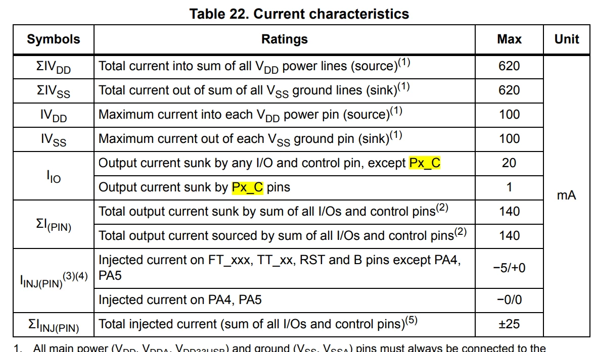

Hi @EthanMankins
For limitations on Px_C IO, you can find the output current sunk by Px_C 1mA.
There is an errata before where some datasheets may not state that the current sunk or sourced by Pxy_C pins is limited to 1 mA when the analog switch between Pxy and Pxy_C pads is closed.
For now, AFAIK, these updates are well documented.
To give better visibility on the answered topics, please click on "Best answer" on the reply which solved your issue or answered your question.Best regards,FBL

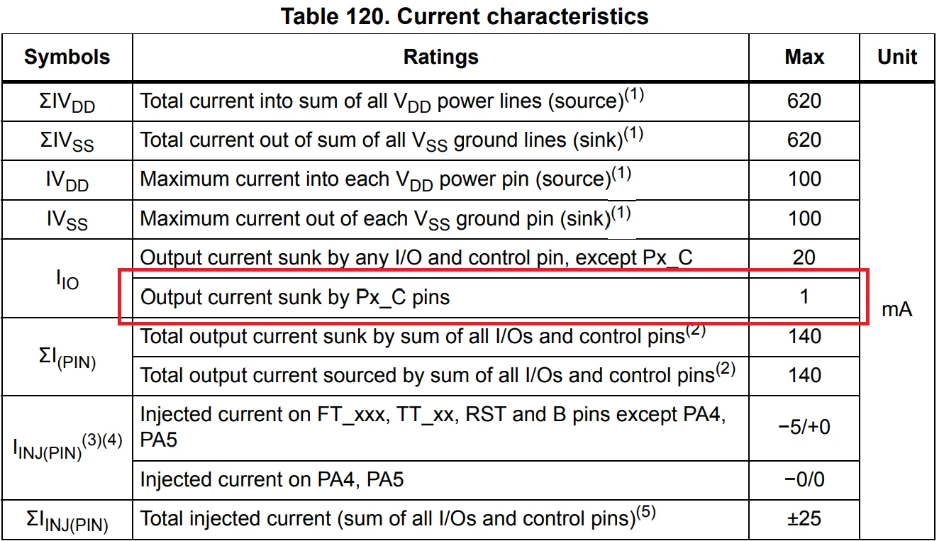

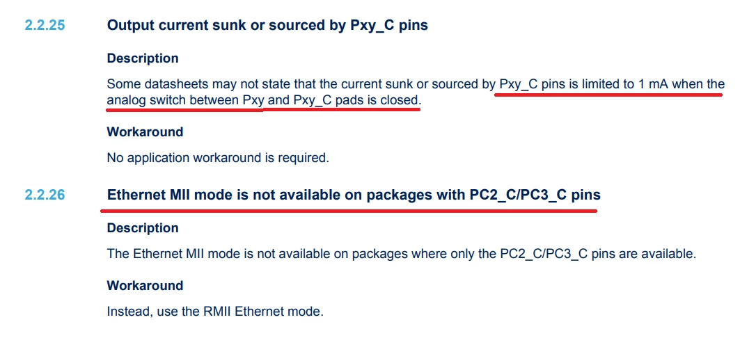

Hello @EthanMankins ,
The constraint on PXY_C pins is the current as the internal switch doesn't support more than 1mA:
DS12110 Rev 10:
From the errata ES0392 - Rev 13:
Errata on the max current and the ETH function:
So you need to insure that you have =< 1mA load on the pin.
