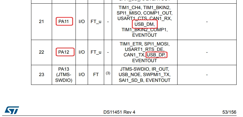

Hello everyone,
I have a Python app that needs to communicate with my custom STM32L432KC board. Before ordering my prototype board, I was wondering if it is possible to do it only via USB with the pins PA11 and PA12, or if I need a USB‑UART chip like the CP2101‑GM?
Thanks
Yes, the STM32L432KC has USB on pins PA11 and PA12:
https://www.st.com/resource/en/datasheet/stm32l432kc.pdf#page=53
via: https://www.st.com/en/microcontrollers-microprocessors/stm32l432kc.html#documentation
That will mean that you will have to do a complete USB hardware design on your custom board, and provide a complete USB software implementation in your custom software.
Depending on your level of both hardware & software experience, you may find it easier to just use a USB-to-UART  adaptor...
(avoiding the complexities of USB hardware & software implementation is exactly why USB-to-UART adaptors exist)
