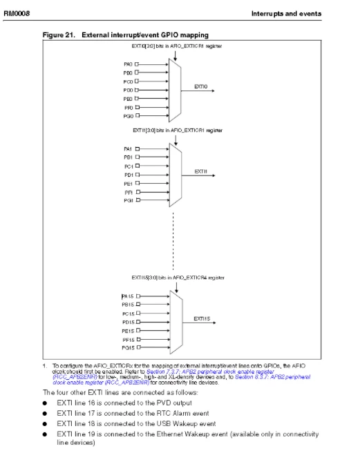

PB1 and PA1 are using the same EXT1?
Posted on October 17, 2017 at 10:45
Hi.
I'd like to use external interrupt PA1 nad PB1 pin.
But I found the following image, I think I can't use the external interrupt PA1 and PB1. Probably I think I have to  use only one to interrupt set.
Can I separately set to the one EXTIx?
because before system already use PB1 for external interrupt
/* PB1 is connected to EXTI_Line0 :: Configuration AFIO_EXTICRx */
GPIO_EXTILineConfig(GPIO_PortSourceGPIOB, GPIO_PinSource1);

but I want to add another external interrupt PA0,PA1,PA2,PA3. in this situation, what am I supposed to do ?

    Your assumption is correct. Because of the fact, that EXTI1 is connected to all Px1 pins (PA1, PB1, PC1, ...), only one of them can be used as a source of interrupt in one time. So in your case it can be either PA1 or PB1.

    It is a pity that ST uses a multiplexer for the EXTI inputs and not a gated OR with a bitmask for selected active inputs.
