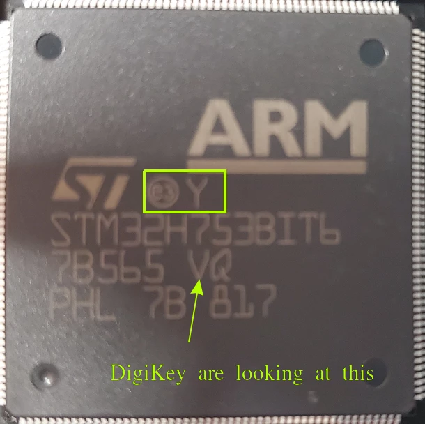

hello, I am working on a board design and need to order STM32H753BIT6 but it has to be Rev V as it supports 480MHz. I am unable to find the order code/manufacturer part number for it.
Ordered one, either it came from
newark https://www.newark.com/stmicroelectronics/stm32h753bit6/mcu-arm-cortex-m7-400mhz-lqfp/dp/52AC7531?ost=STM32H753BIT6&ddkey=https%3Aen-US%2FElement14_US%2Fsearch
or Digikey https://www.digikey.com/products/en?keywords=STM32H753BIT6 as it says 480MHz but the device that came was Rev Y and can only run at 400MHz.
on both links the Manufacturer Part No: is same
could not find any info about ordering rev V and want to make sure that we have the correct part number to put boards into production, any help will be much appreciated.

Did you talk to Digikey or RS aboyt the stepping. When selling Rev Y parts and sdveryising 480 MHz, something is wrong.

Mike R
Mike RAuthor
August 21, 2019
thank for trying to help on this. We have been contacting all suppliers but because there is no separate part number, all suppliers are confused. its kind of bad why would ST not have seperate part numbers, its just causing so much confusion and now our production has stopped.
DigiKey initially said that they have Rev V but see the below photo they sent from stock and we marked it for them, as per the datasheet this IC is Rev Y, DigiKey are looking at the bottom V which stands for something else. After we pointed this to DigiKey, they came back and said that yes its Rev Y and there was some confusion and cant order Rev V parts. But the problem now is that no supplier can supply Rev V, so basically we have no place to order Rev V parts.
can ST help us get the Rev V parts as its causing a lot of problems to get the right part numbers.

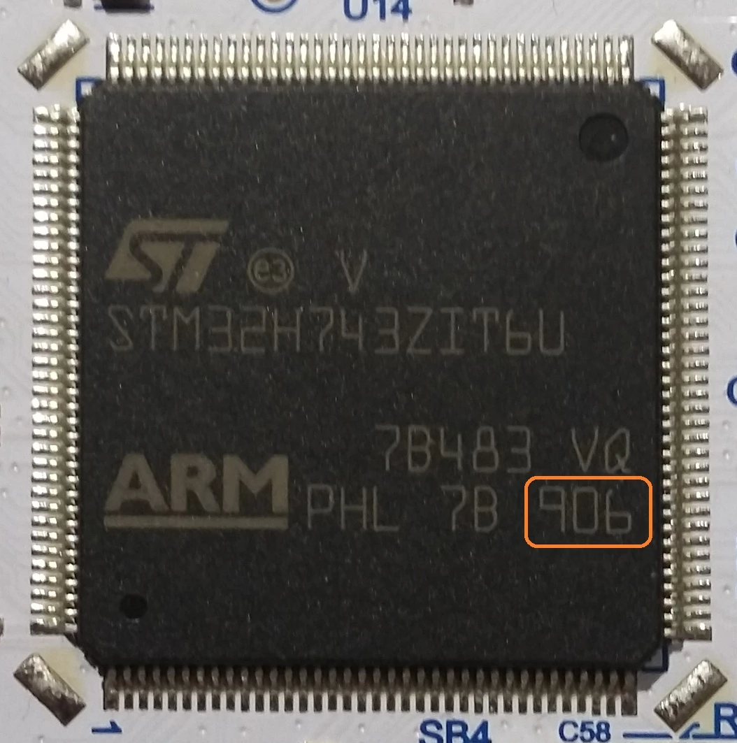

Use the production date code. You definitely don't want any 2018 product.
Here 2019 Week 6

I don't know what the cut off date was for Y-step silicon, but I've got X-step devices from the French facility dating from 2018 Week 20, and V-step devices from the first weeks in 2019.
The Production Date information should be all over the reels, boxes and packaging.
