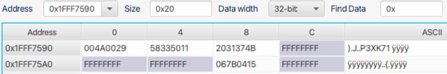

I’m working with an STM32L476 and need to parse its 96-bit Unique Device ID (UID).
According to RM0351, the UID starts at address 0x1FFF 7590.
Reading that region with STM32CubeProgrammer gives:
• 0x1FFF 7590 : 0x004A0029
• 0x1FFF 7594 : 0x58335011
• 0x1FFF 7598 : 0x2031374B
So the full UID (high → low) is 0x2031374B 58335011 004A0029.
According to this documentation, the lower 32 bits encode the X/Y coordinates of the die on the wafer, in BCD.

Best answer by mƎALLEm
I've got a confirmation internally regarding question 1: indeed X = bits [15:0]  and Y = bits [31:16].
For the second question you need to an online support request over this link.

I can answer the first question,
According to this thread: STM32H7A3 Unique Device ID number question
X = bits [15:0]  and Y = bits [31:16], I can check.
Meanwhile, I will try to check internally for the format of X/Y and get back to you if I get the information.
