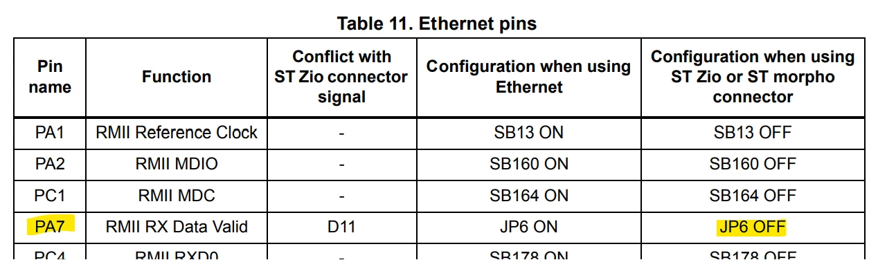

PA7 pin voltage problem (STM32f767zi)
Hello, I would like to ask you to know how it is that the PA5 pin in OUTPUT (non-pullup and non-pulldown) delivers a voltage of only 2.6 V instead of 3.3 V like the others?

Per the schematic and the user manual, PA7 is used by the ethernet. If you want to use it through the header pins, you can isolate it from the ethernet by removing the JP6 jumper.

mƎALLEm
Dec 15, 2023 2:34 PM UTC
Hello @Paul_TESSON
You question is not clear!
Which GPIO? PA7 or PA5?
In which config? Output Push Pull or Output Open Drain?
Could you please show us the code of your pin configuration?
Paul_TESSON
Dec 15, 2023 4:16 PM UTC
PA7 sorry

Probably you have a hardware issue, like something else pulling down the pin, or an unexpected short, or other hardware gremlin.
Paul_TESSON
Dec 15, 2023 4:18 PM UTC
I tested on 3 st32f767zi, same problem
mƎALLEm
Dec 15, 2023 4:23 PM UTC
Please provide your schematics if you are using a custom board or tell us on which ST board you're doing the test.
Also provide your code.
TDKBest answer
Dec 17, 2023 4:18 PM UTC
