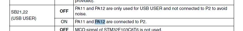

hi,
below is the code i wrote just to change the states of pins PA10, PA11, PA12 and PA even though pin PA10 and pin PA15 gives the correct output to the functionsGPIO_SetBits() andGPIO_ResetBits(); PA11 pin and PA12 pin doesn't seem to change its state at all. those two pins always stays at logic low (i read around 0.10 Volts rather than perfectly 0 Volts on both pins). can anyone explain me why??void GPIO_Init_Motor(void)
