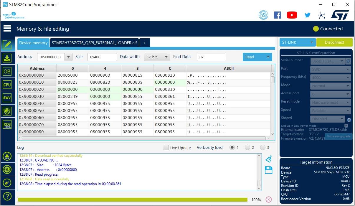

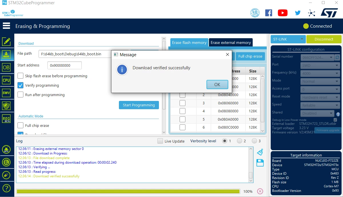

Using my own build STLDR file, I could able to down load the dummy binary file via cube programmer as well as erase and read functions with external loader .
But i could not able down load the elf ( main code ) file via cube programmer and cube ide debugger.
From the above analyze code's  are fine . i think cube programmer and cube ide debugger not catching the elf file but i don't know how using  the  https://github.com/cturvey/stm32extldr/tree/main/h7_w25q128   stldr file  is working fine !.
