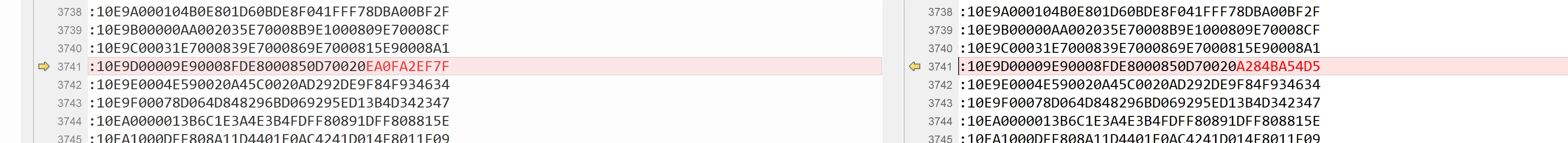

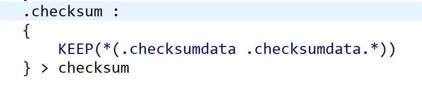

I tried this:
const uint32_t __attribute__ ((section(".checksumdata"), used)) CodeChecksum = 0x12345678;
But when I build code, It doesn't changes only ".checksumdata", but also other intermittent bytes in hex file. How we can resolve this issue?

Welcome @Jayant, to the community!
A hex file in Intel format consists not only of the data bytes, address and length, but also the checksum of the respective record. So if you change the value of CodeChecksum, the checksum at the end of the record will inevitably change as well.
Have you made a text comparison of such hex files and what exactly is the difference?

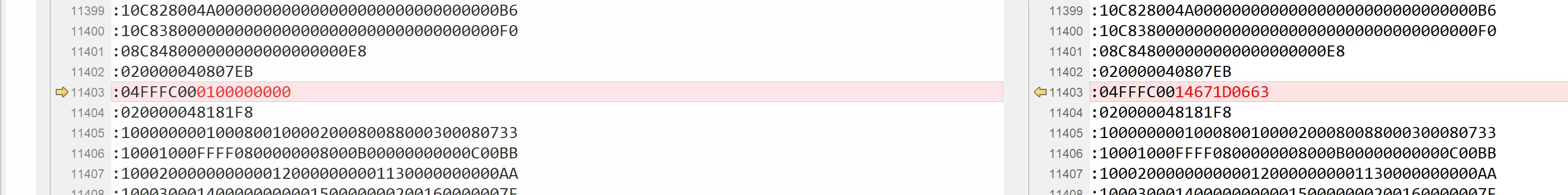

JayantAuthor
May 17, 2024
But when I build code, It doesn't changes only ".checksumdata", but also other intermittent line in hex file. How we can resolve this issue?
const uint32_t __attribute__ ((section(".checksumdata"), used)) CodeChecksum = 0x61d6714;
Expected:
Not expected:

As I wanted to have CRC at very end of flash, too, I did the  following: In ld script:
/* CRC32 checksum goes into FLASH at the very end */
.chcksm ORIGIN(FLASH) + LENGTH(FLASH) - 4 :
. = ALIGN(4);
KEEP(*(.chcksm))
. = ALIGN(4);
} >FLASH
I.e. no extra memory section required. Then 'objcopy -O srec --gap-fill 0xFF file.elf file.hex'. This will emit the line with the checksum in a fixed 16-byte record. Finally my Makefile gets start and end addresses, calculates the actual checksum incl. the required srecord stuff and injects that into the srecord file:
BEG=$$(nm $< | sed -n -E 's/^(\w+).*_sidata$$/\1/p' | tr [:lower:] [:upper:]); \
END=$$(nm $< | sed -n -E 's/^(\w+).*chcksm$$/\1/p' | tr [:lower:] [:upper:]); \
CHCKSM=$$(./$(BUILD_DIR)/calc_crc32 $@ 0x$${BEG} 0x$${END}); \
sed -i -E "s/^S3..$${END}.*$$/$${CHCKSM}/" $@;
Slightly cumbersome, but once it works, it does work as desired.
