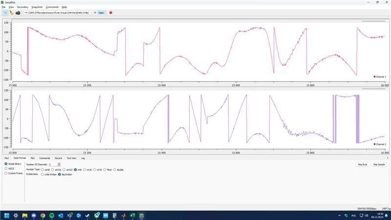

Hello everyone,
I'm working on a project where I need to transmit audio data from two microphones (left and right channels) over UART from an STM32 microcontroller. The audio data is initially sampled at high resolution (32-bit), but I’m converting it to an 8-bit format to reduce the data size before transmission.
The audiowave seems alright for quiet sounds, but when it comes to louder things the amplitude on the output seems to clip, or to cut when it reaches 127 and it continues on -128
my settings are:
DFSDM: 76,8
DIVIDER for the output clock: 32 so i get 2,4MHz
FOSR: 25 so i get 98kHz on each micropfone, so as i think for 2 microphones = 48kHz according to excel included in DFSDM tutorial.
Right Bit shift: 4 for both mics

Also the problem is (as the serialplot shows) i only recive 24k of samples for second.
Can you please help me to get the amplitude to better shape which is not as shredded as it is.

How does shifting a 32-bit sample 8 places right get you a signed 8-bit sample? You get 24-bit, but not sign extended
What's the working range of the 32-bit samples? What form, and unsigned value? What's the 'zero' point.

Hey, its because i use Right Bit shift = 16. As I understand the 8 bit from 32bit sample stands for external audio data so i use >>  8 to get 24 bit audio, and i use also Right Bit Shift to get smaller samples fitting 8 bit.
Can you please say if im right or not or give me some materials to learn from?
