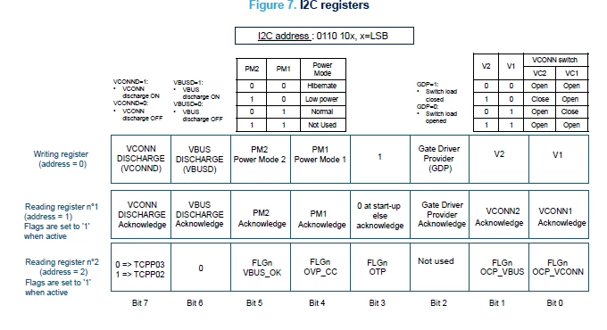

Could you perform register n°2 readout after the fault ? To confirm OCP fault (see table below).

The current measurements on the Vbus showed that we do infact have around 5A that is tripping the TCPP OCP. The register reads 0xA2 after the Flagn.
