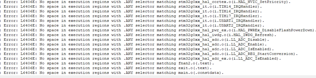

I'm using STM32G0 with 64KB of flash memory and 8KB of RAM
if optimization is OFF, its giving error as below
and if optimization is ON Level-1
its not giving any error
So let me know what kind of error i'm facing
Compiler - keil

You answered it yourself. The code is larger than the flash size you have available.
Potential solutions:
  • Refactor the code to use less memory
  • Compile with optimizations on
  • Buy a chip with more flash

Simply you are exceeding the flash memory size.
In fact your application is at the limit of the flash size 64kB. If you enable the optimization your binary < 64kB and that fits in the Flash and if you disable the optimization, the binary > 64kB exceeding the memory size of the MCU.

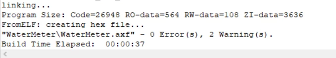

But when optimization is of level-1 than occupy flash size is 27KB only, how its possible to optimize the code size more than half

My guess is: you are using trial/resrticted version of MDK-ARM with 32 KiB size limit.
Solutions:
1. Switch to STM32CubeIDE.
or
2. Enable STM32F0/G0 license. This will unlock the size limit but lock your MDK-ARM to F0/G0, so you won't be able to use it with any other microcontroller.
