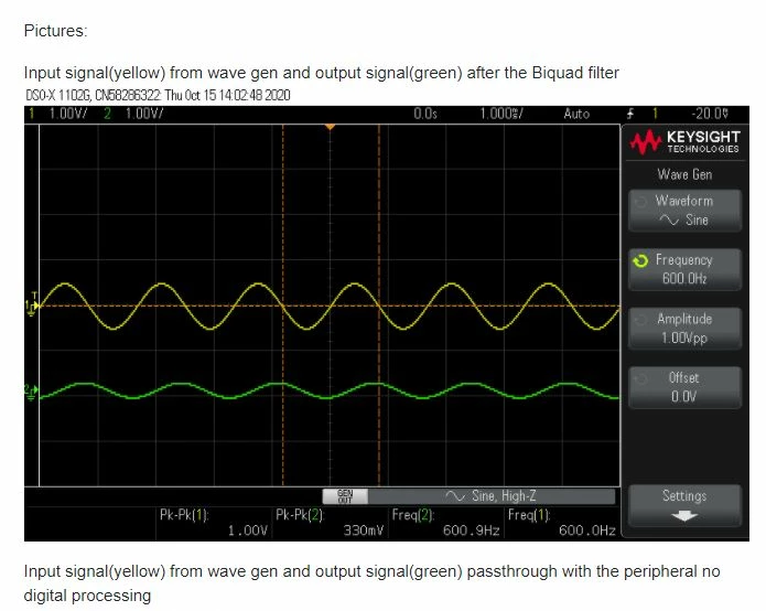

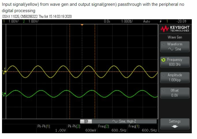

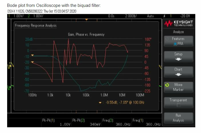

What's going on is that I finally got my low pass digital filter working on the STM32H753ZI using the PMODI2S2 peripheral and I noticed the output signal is extremely low ~340mVpp this is after the biquad filtering. If I take out the low pass filtering the output signal then raises to around ~600mVpp.

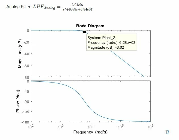

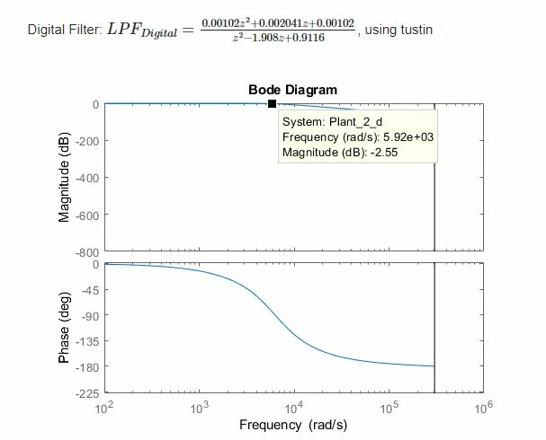

What's causing this phenomenon? The digital filter bode plot says the gain from very low frequencies up to the cut off is 0dB so I dont understand whats going on. The only thing I can think of is the biquad filter is causing an attenuation perhaps?
Or could it be the setup for the I2S hardware within the MCU?
