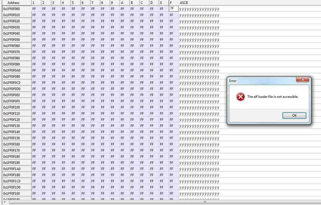

Hi all,
i have an problem with the OTP Programming. I use an STM32F429 and ST-Link/V2 with the Software STM32 ST-Link Utility V3.9.0.
The OTP Bytes started at 0x1FF0F000. I see the content of this Bytes (0xFF) with blue background color. I try to change one of the Bytes in 0x7F. But it doesnt't work. I become the following error message:
Are there any ideas for my problem?
Best regards
Kai Paulus

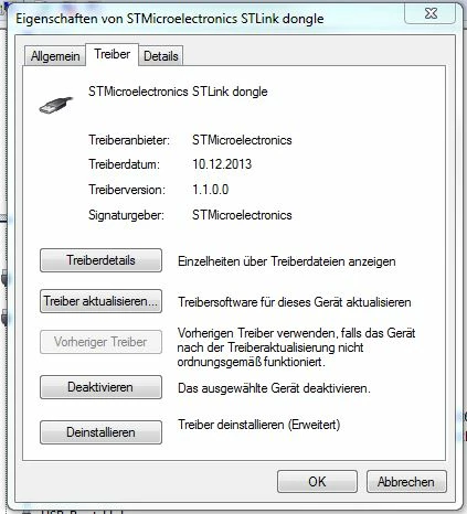

    Hi Hannibal,

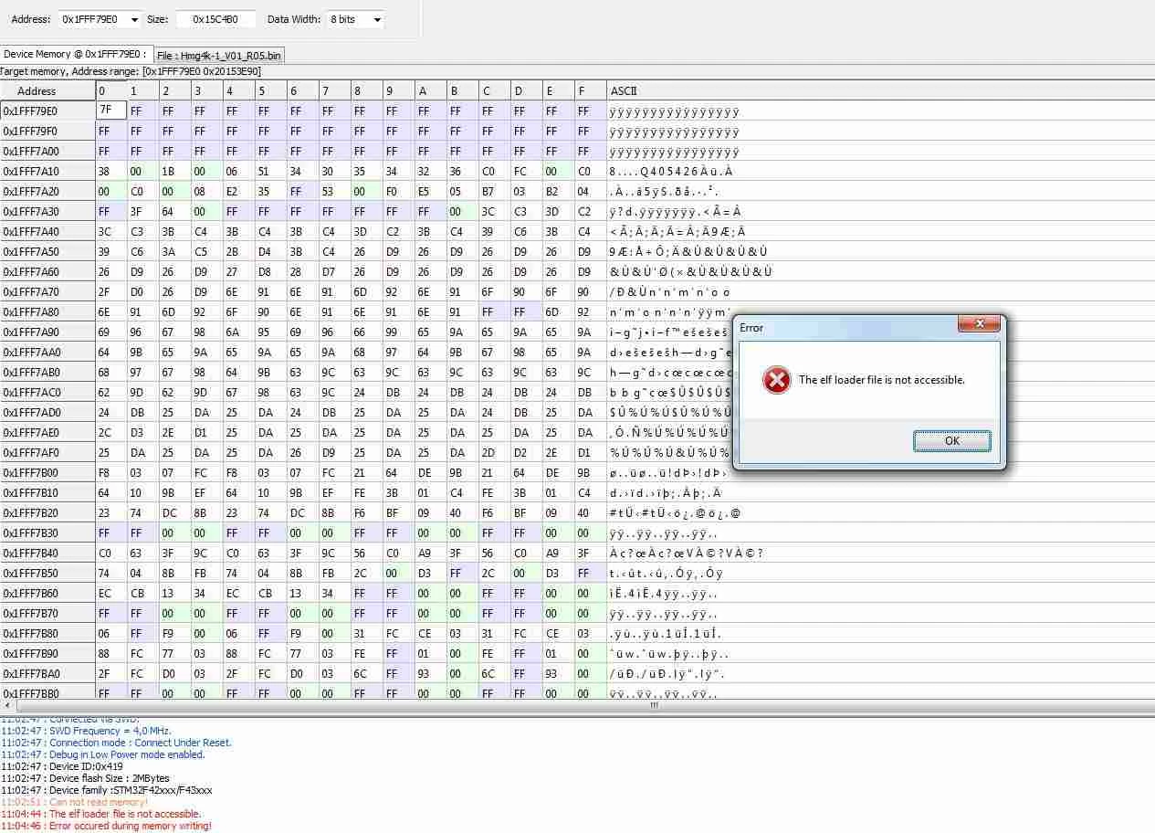

    many thanks for the answer. But it does still not work. Here the error message
    Driver Details:
    I see the same message when i try the test with an STM32 F4 Discovery Kit.
    Best regards.
    Kai Paulus

    Posted on August 10, 2016 at 06:57
    the OTP Programming does not work with the
    ST-Link Utility Version 3.9.  With 3.8 Version it works.

    Hi  kai.paulus,
    We confirm the issue ad will be fixed in the next release. Sorry for the inconvenience.
