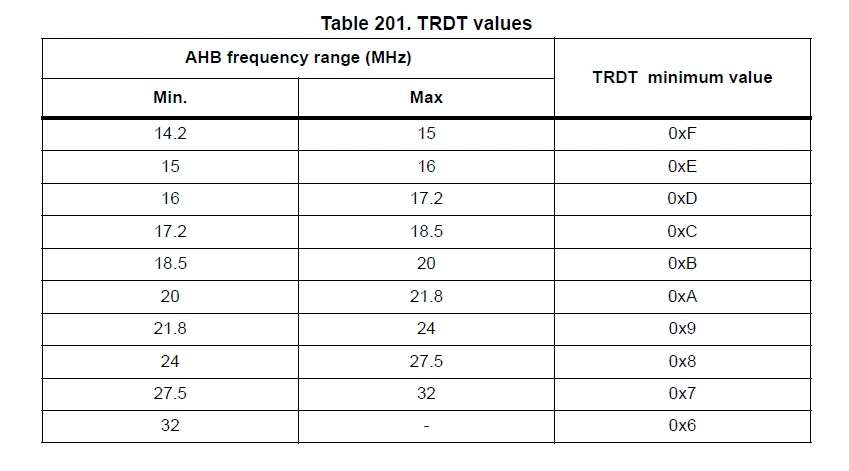

In RM0090 rev.15, OTG_HS_GUSBCFG.TRDT description (p1410) links to Table9, which gives a single value, 0x09.
However, in CubeF4, the TRDT value is determined based on the actual link speed (regardless of whether internal FS_PHY is used or an external ULIP PHY), as determined by USB_GetDevSpeed(), i.e. by reading OTG_HS_DSTS.ENUMSPD: if it is USB_OTG_SPEED_HIGH, the value of USBD_HS_TRDT_VALUE (== 0x09) is used; otherwise the value is determined based on AHB speed in the same way as for OTG_FS (which is contrary to documentation which calls for a single value).
IMO, both are wrong.
My guess is, that the documentation should say '0x09 if ULPI PHY is used, the variable value based on AHB asi in the OTG_FS chapter if the internal FS_PHY is used'.
And then Cube should follow this rule, i.e. set TRDT based on the PHY used rather than based on the detected speed.

    Both OTG_HS and OTG_FS in RM0090 contain a 'Choosing the value of TRDT ...' subchapter, adding to the confusion.
    If the values given in the tables are 100% OK and should the description be precise enough, those subchapters ought to be removed.

    • For the
      FS mode
      , the TRDT minimum value depends on the AHB frequency range, it should be configured as described in the table below:

    I don’t see any mismatch between the information on the reference manual and the driver.
    Please let me know if I misunderstood your request.

    In 'F4xx, we have 4 possible combinations for USB device:
    1. the OTG_FS module with its internal FS_PHY operating at FS
    2. the OTG_HS module with its internal FS_PHY operating at FS
    3. the OTG_HS module with external ULPI PHY operating at FS
    4. the OTG_HS module with external ULIP PHY operating at HS
    As TRDT expresses a synchronisation parameter between core/AHB clock and PHY clock, in my opinion, in cases 1 and 2 table 201. pertains, while in cases 3 and 4 TRDT should be set according to table 209.
    If the above is true, then the following two problems arise:
    1. The OTG_HS chapter (which is relevant for cases 2, 3 and 4) in RM0090 refers to table 209 only, which is IMO wrong for case 2.
    2. The code in Cube uses table 209 only for case 4 (uses the detected link speed rather than the type of PHY to distinguish between the cases) and that's IMO wrong for case 3.
