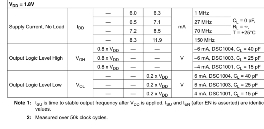

I am slightly confused while selecting the external high-precision Clock source for our application that uses STM32G474RxT3 series MCUs. I want to use DSC1001DL2-024.0000T as I have these in our inventory, I checked for the operating voltage range & recommended Frequency range as given in the datasheet of STM32G474.

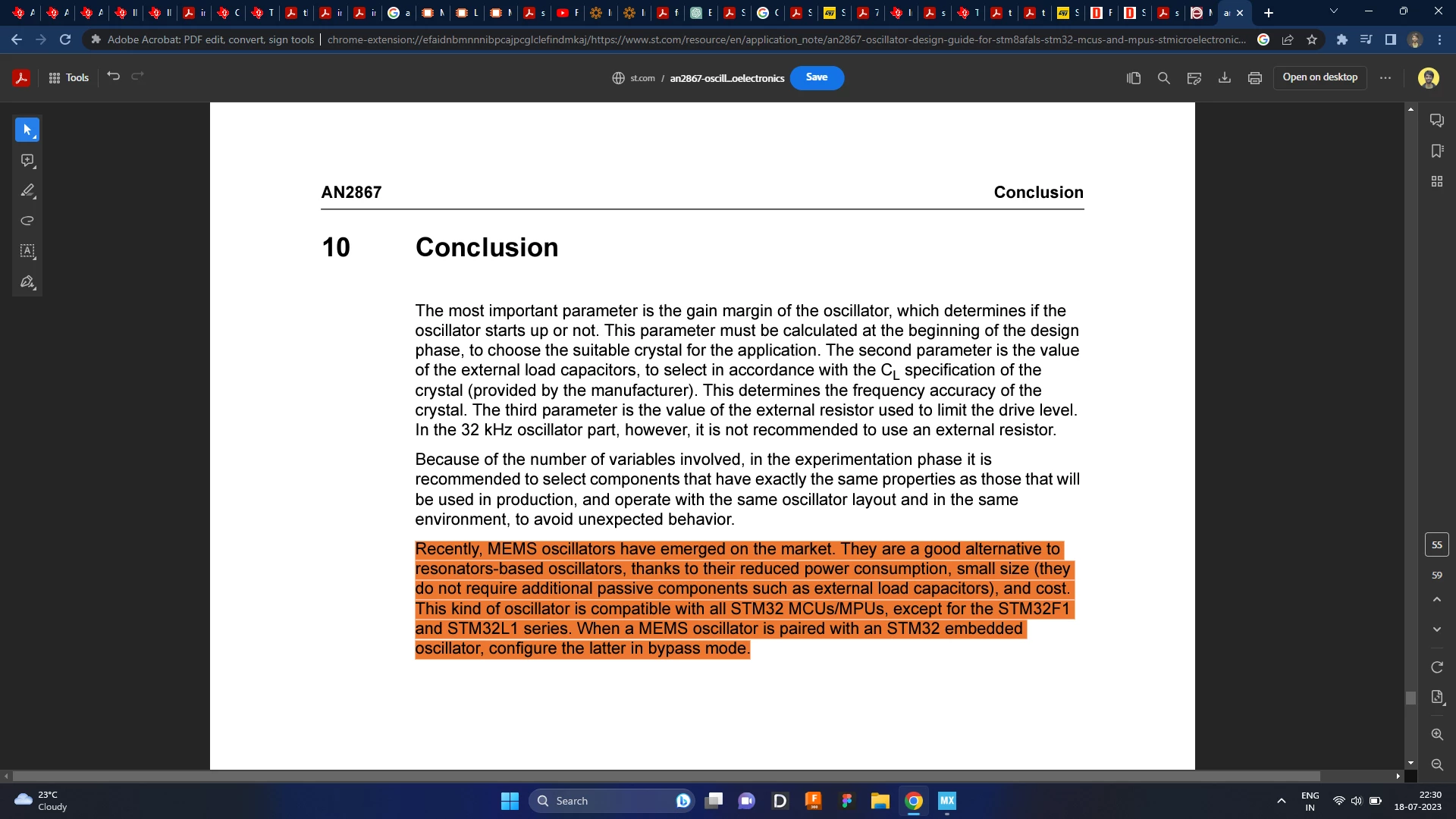

I however am unsure as the AN2867 specifies Crystal/Resonator list only. Can someone confirm if choosing MEMS Oscillator like DSC1001DL2-024.0000T shall be suitable or not?

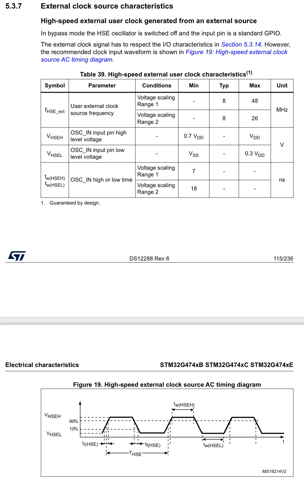

Dear @Chubs
Here is attached the VOH/VOL of the Oscillators and as well the VIH and VIL of the STM32G4 in bypass mode - They are compatible with selected frequency of 24MHz in all ranges .
Hope it helps you .

AScha.3
July 2, 2023
shure, no problem.
just set "bypass" clock for HSE , so cpu expect an oscillator.
and i put an damping resistor, 50...80 ohms , in clock line, to reduce reflections. (some oscillators have so short rise time, they provoke ringing on the edges.)

ChubsAuthor
July 2, 2023
Thanks @STOne-32 for your prompt response, the AN2867 also mentions in the conclusion section of the Application Note that MEMS Oscillators are supported.

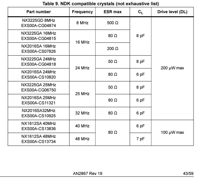

As per ST application note AN2867, for the selection of 24MHz ST is recommending NDK crystal for 24 MHz as shown in the screenshot. But unfortunately, the NDK crystal parts have unconfirmed status. I have contacted the NDK manufacturer and still they are not responding. Could you suggest any alternate 24MHz part for the MCU STM32G431Mx? Or could you please confirm if I can go ahead with NDK part.
Thanks
ChubsAuthor
March 21, 2024
Hello @sreejithrnair,
Attaching NDK products from Digikey's listing for your reference here.
Also, you can opt for Oscillators or Crystals either of them.
I have used TI's BAW Resonators for my use case as our devices are exposed to lifetime of high vibrations.

In my project, I am using 24MHz crystal oscillator. In the given list of Digikey NDK crystal products, the close frequency matching crystal is NDK's NSC5083D-24.576M NSC5083D-24.576M NDK America, Inc. | Crystals, Oscillators, Resonators | DigiKey which is having frequency of 24.576 MHz. Is this value permitted instead of 24 MHz frequency?
I also have found out a suitable crystal from Sunstu with exact matching specs of NDK 24MHz crystal. SXT3248EA48-24.000M Suntsu Electronics, Inc | Crystals, Oscillators, Resonators | DigiKey Marketplace
Can you please suggest if the part SXT3248EA48-24.000M is suitable contender for my application?
