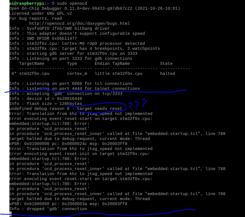

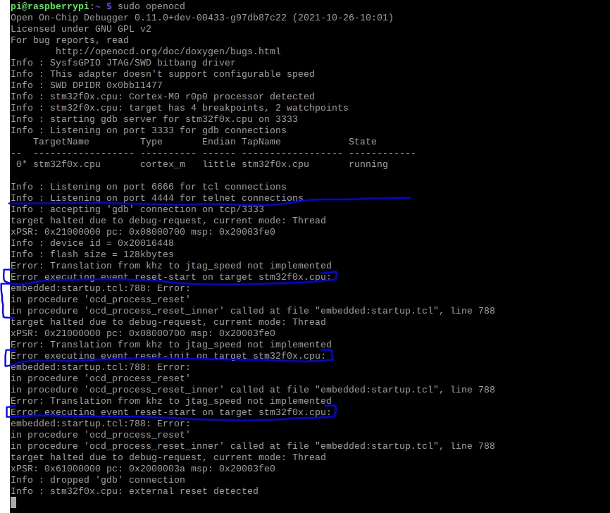

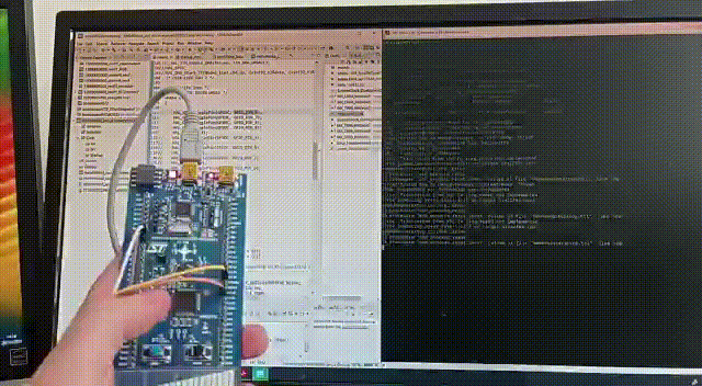

Trying to build my own raspberryPi wireless SWD debugger.(bitbanging SWD, without stlink)0693W00000FDmMGQA1.gifI am able to flash and halt the code trough cubeIDE but openOCD is not able to reset the chip, i have to do it manually for now (see gif above).
Pesky errors im getting:
error in procedure 'ocd_process_reset'
0693W00000FDmFZQA1.pngError executing event reset-start on target

    My openocd.cfg looks like:
    source [find interface/sysfsgpio-raspberrypi.cfg]
    transport select swd
    set WORKAREASIZE 0x2000
    source [find target/stm32f0x.cfg]
    reset_config srst_only srst_nogate
    adapter srst delay 100
    adapter srst pulse_width 100
    bindto 0.0.0.0
    init
    targets

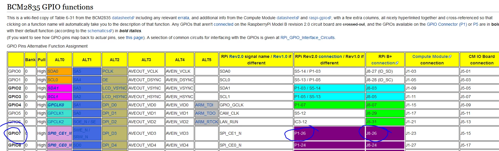

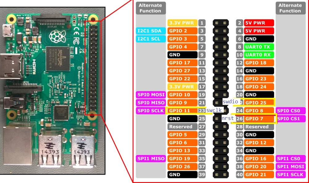

    0693W00000FDmn2QAD.pnglooks like i got the pin number right but im going to try other nRST pins just in case

    changing the sysfsgpio_srst_num , didnt worked, i tried gpio8 and gpio24, same errors

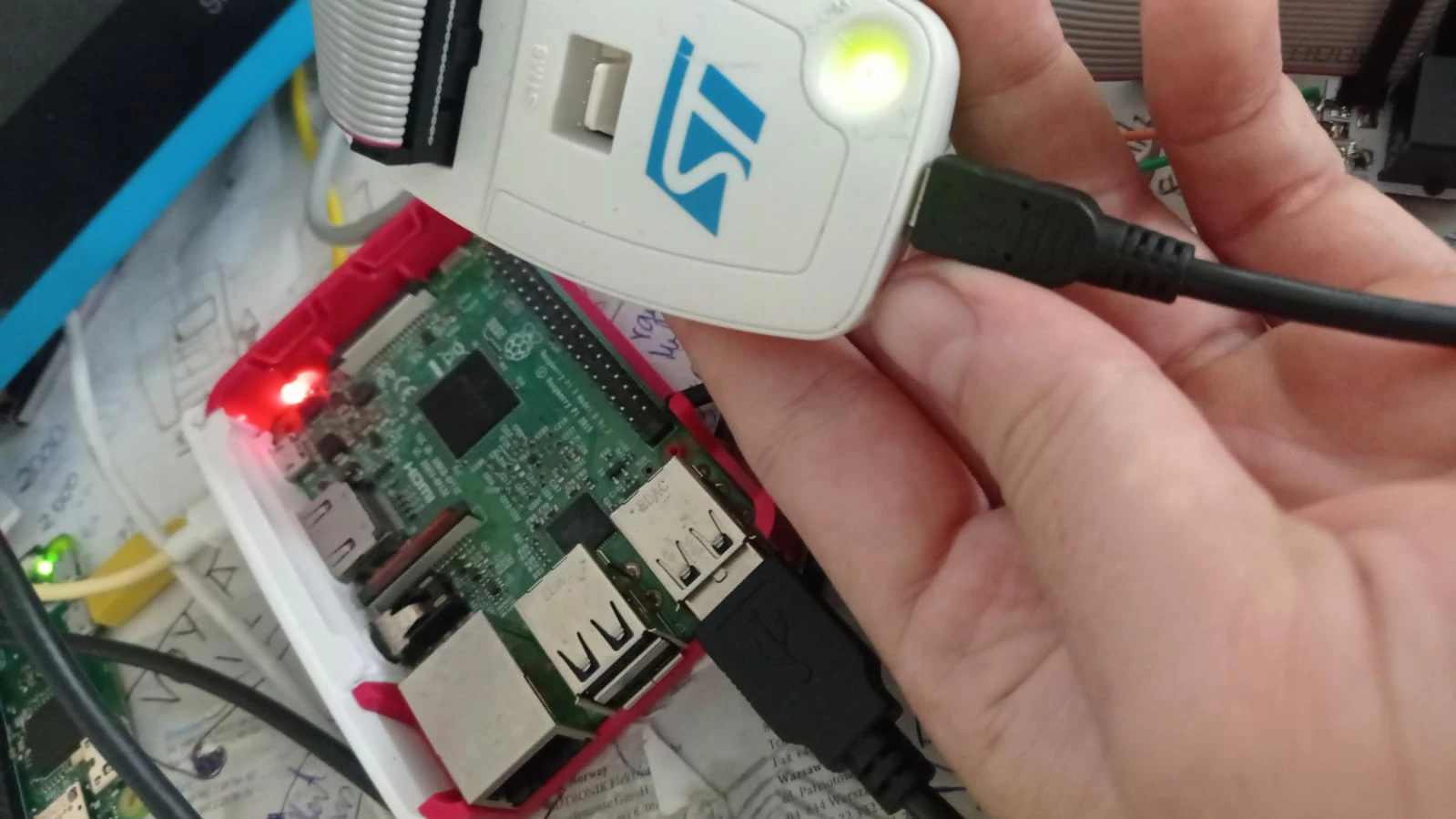

    0693W00000FDobSQAT.jpgi gave up, im sticking an stlink to my raspi
    openocd.cfg file changes :
    source [find interface/stlink.cfg]
    transport select hla_swd
    it works first try, everything
