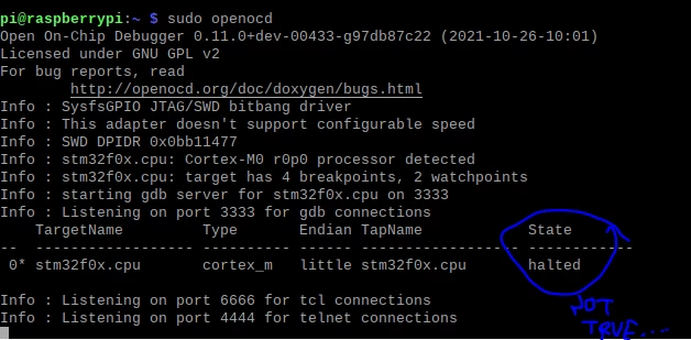

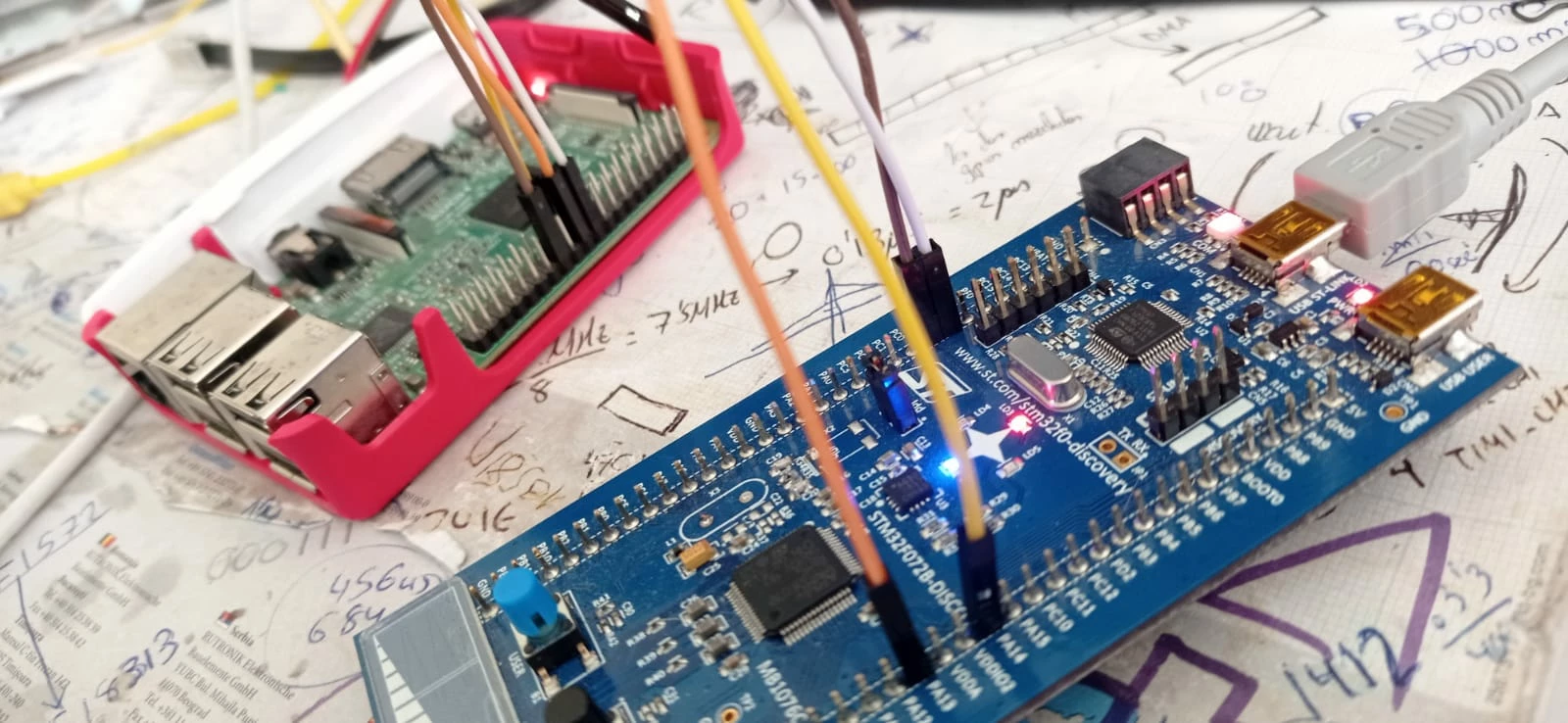

I am trying to flash code in my stm32 via SWD interface with a raspberryPi.(swd is bitbanged no stlink used)
With my raspberryPi Zero i followed this tutorial, wired the raspy with my stm32f105 together.
0693W00000FDm3jQAD.pngMy openocd.cfg file looks like:
source [find interface/sysfsgpio-raspberrypi.cfg]
transport select swd
set WORKAREASIZE 0x2000
source [find target/stm32f0x.cfg]
reset_config srst_only srst_nogate
adapter srst delay 100
adapter srst pulse_width 100
bindto 0.0.0.0
init
targets
#reset halt

My mcu doesnt look to be reseting at all...(i have a blinky programm running)
I probed the nRST signal with the oscilloscope and it remains 3v3 constant

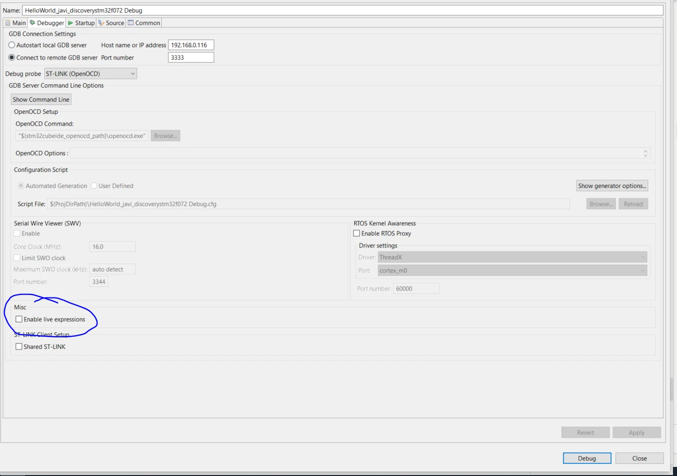

So, i changed configurations a bit and using my raspberry 3 model B v1.2 made it "work"
Now the cubeIDE is able to halt the stm32 chip and step trough the code (debug build)
0693W00000FDm5yQAD.pngit took me a while but if i untick "enable live expressions" (right click in the progect>debug as>debug configuration>debugger)
the debugger was able to halt the programm at runtime.
for now im able to load the programm and halt the mcu (trough cubeide debugger).
Im not able to reset the mcu for some reason.
