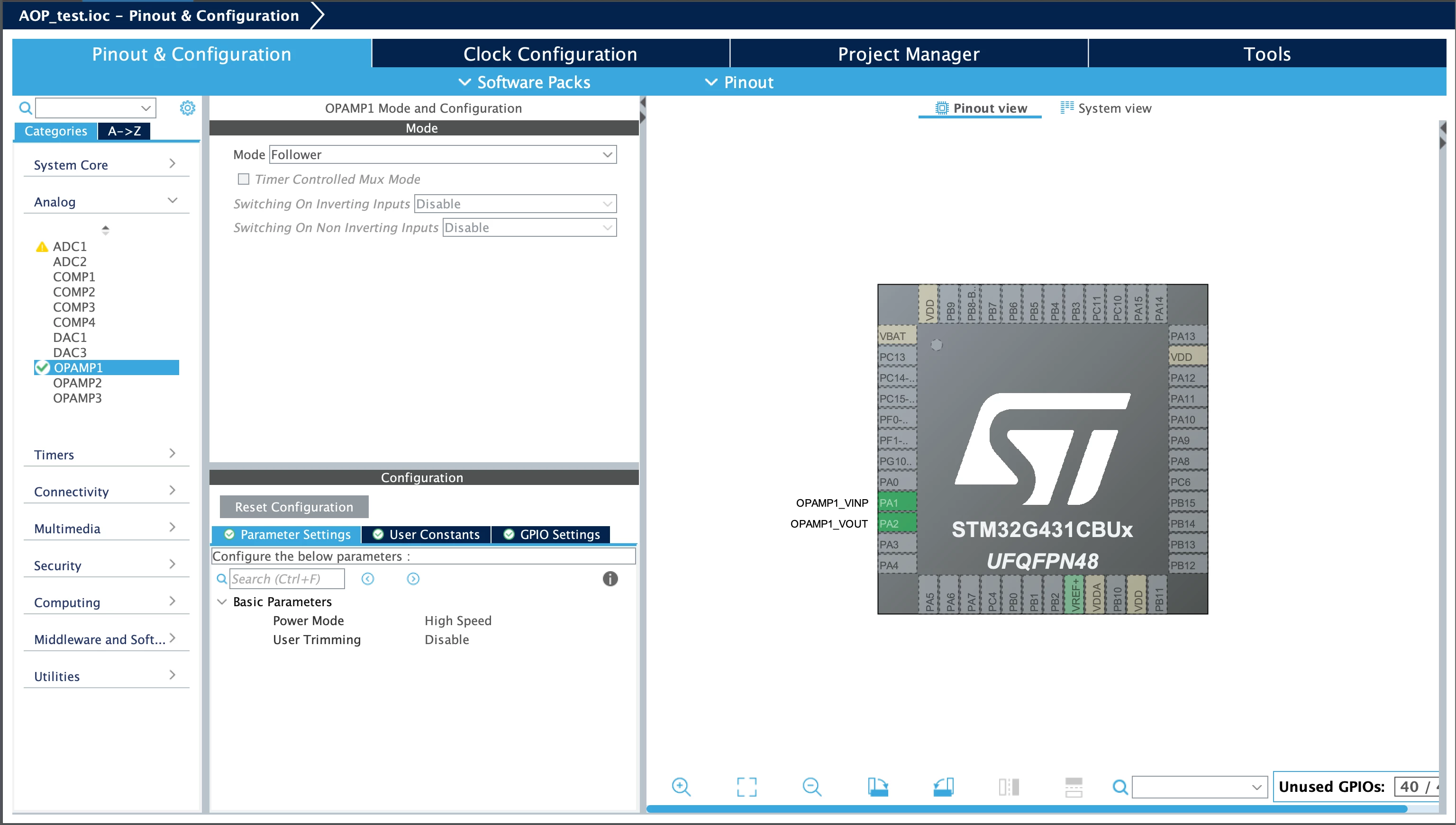

I'm trying to use OPAMP1 on stm32g431 adapted by WeActStudio (https://github.com/WeActStudio/WeActStudio.STM32G431CoreBoard)
My Cube settings:

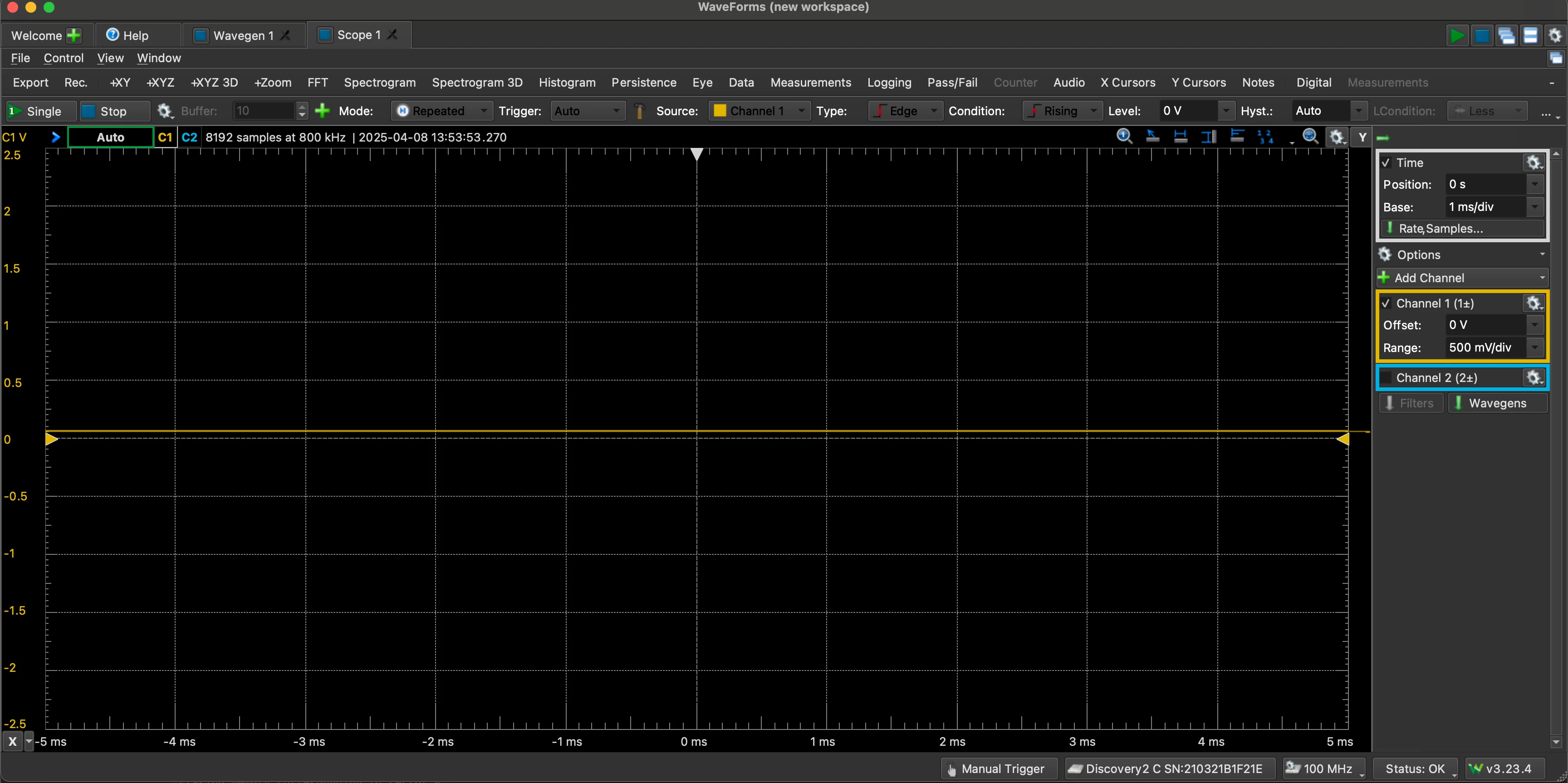

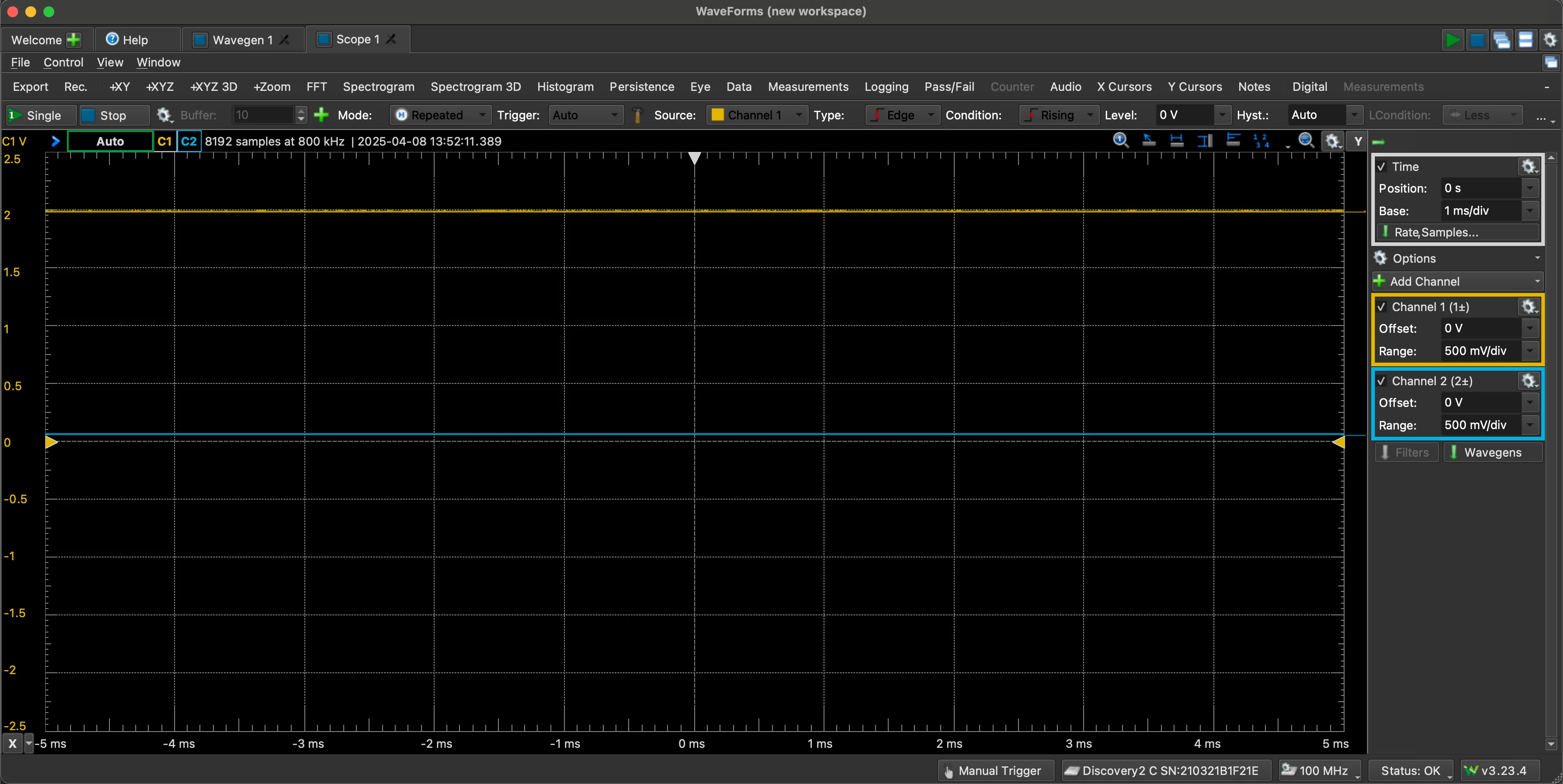

Scoping on generated voltage going to PA1 show 2V:
Scoping Vout on PA2 showing 0V instead of 2V:
I've only the weact version so I can't compare with other hardware, doesn't know if I'm misconfigured Cube.

Hello @Sercurio and welcome to the community;
May OPAMP_Follower example can help you to check your software.
To test OPAMP_Follower example, a voltage waveform is generated by the DAC peripheral and can be connected to OPAMP input. This example is based on the STM32G4xx OPAMP LL API.
I hope this help you.
Thank you.
