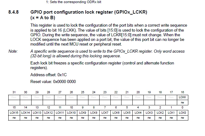

There is no clear information in the reference manual about port pin configuration locking one by one. For example (desired code):
void SomeFunction()
 // locking pin configuration one by one
 LL_GPIO_LockPin(GPIOA, LL_GPIO_PIN_0);
 LL_GPIO_LockPin(GPIOA, LL_GPIO_PIN_1);
 LL_GPIO_LockPin(GPIOA, LL_GPIO_PIN_2);
May I lock pin's configuration one by one, not all at once (see code below)?
void OtherFunction()
 // locking all pins configuration at once
 LL_GPIO_LockPin(GPIOA, LL_GPIO_PIN_2 | LL_GPIO_PIN_1 | LL_GPIO_PIN_0);

Yes, you can lock only 1 pin for each call of the LL_GPIO_LockPin.

FYI Full source code to the libraries is provided, so you can review it, and expand upon it.

You can do it with both ways, by Oring all pins or one by one, but better to lock them at once for performance reasons.
This is the register:
You can write all the bits at once (by oring).
See also this link.  LL_GPIO_PIN_ALL value is the oring of all pins.

Thanks a lot, colleagues! In my application it is very convinient one by one way of configuring port pin locking.
