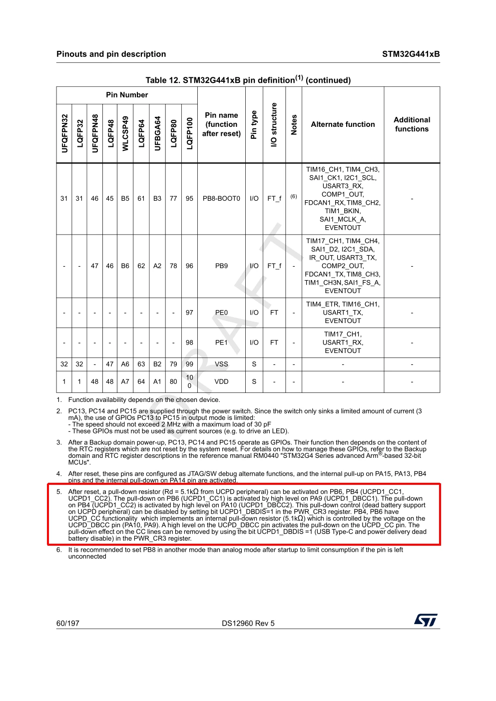

waclawek.jan
June 14, 2025
This is consequence of the USBC PD dead battery mechanism.
As the text says, PWR_CR3.UCPD1_DBDIS to disable this feature (don't forget to enable PWR by setting RCC_APB1ENR1.PWREN prior to this).
Noko327AuthorBest answer
