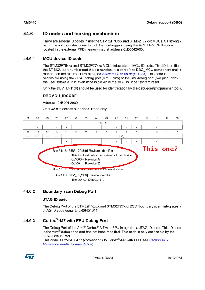

On the STM32F777 I am trying to determine if there is a readable silicon revision level.
 I realize that I can read the ID Code Register at 0xE0042000, but I am not sure how the silicon revision is indicated for a specific device. Is it readable though the codes on the device itself?

void CORECheck(void) // sourcer32@gmail.com
 uint32_t cpuid = SCB->CPUID;
 uint32_t var, pat;
 printf("CPUID %08X DEVID %03X REVID %04X\n", cpuid, DBGMCU->IDCODE & 0xFFF, (DBGMCU->IDCODE >> 16) & 0xFFFF);

From the F746
  1. STM32 1024 KB FLASH, 320 KB RAM, 002B003A-32345109-37343138 UNIQUE
  2. CPUID 410FC271 DEVID 449
  3. Cortex M7 r0p1
  4. C0000000 FFFFFFF8 00000000
  5. 10110021 11000011 00000040
  6. FPU-S Single-precision only
From the F767
  1. STM32 2048 KB FLASH, 512 KB RAM, 001B002A-33355109-36343130 UNIQUE
  2. CPUID 411FC270 DEVID 451
  3. Cortex M7 r1p0
  5. 10110221 12000011 00000040
  6. FPU-D Single-precision and Double-precision
Tesla DeLorean
Guru
Jan 22, 2019 2:14 AM UTC
A cleaner list of CM7 parts in ST's portfolio
H743XI Z
CPUID 411FC271 DEVID 450 REVID 1001
Cortex M7 r1p1
STM32H7xx
C0000018 20000F48 00000000
F746ZG
CPUID 410FC271 DEVID 449 REVID 1001
Cortex M7 r0p1
STM32F74xxx or F75xxx
F767ZI
CPUID 411FC270 DEVID 451 REVID 1000
Cortex M7 r1p0
STM32F76xxx or F77xxx
F722ZE
CPUID 411FC271 DEVID 452 REVID 1000
Cortex M7 r1p1
STM32F72xxx or F73xxx
