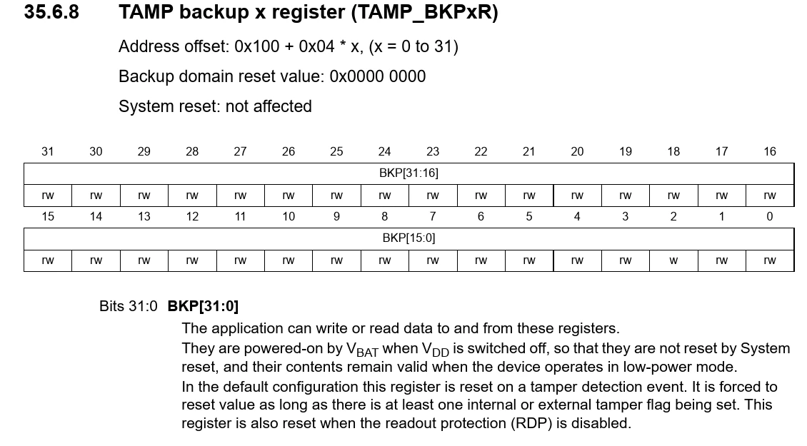

on my stm32g473 I need to save a variable permanently, even on reboot. I want to use it to control the volume of my dac, and use up and down buttons to change the gain. This variable has to be remembered ater reboot, should I write to flash?

AScha.3
Apr 6, 2023 4:24 PM UTC
you need a backup 3v3 cell, Vbat. then backup registers can keep content...
