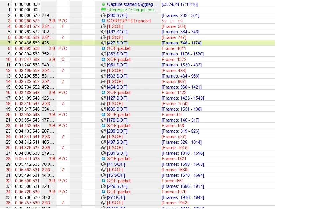

Situation: USB HS using internal PHY in FS mode as Host.
While we use Zephyr OS and updated to the latest version of HAL/LL drivers we still observe CRC errors on the bus during normal runtime. The issue regarding the sleep clock on the HS PHY was found and we disabled it and that made the USB port sort of usable in Zephyr. We do however still observe SOF frame issues with CRC errors in them as mentioned before. The issue stops completely when we stop the ARM core. As if something runtime influence the core. I was not able to find a place in the code that could potentially influence the core. It even happens when the USB port is fully idle, while other parts of the GUI (TouchGFX, so DSI/LTDC are running as well) keep running.
Another indication was, on some boards it was so bad that I had to increase PLL3 to max 960 MHz output of the VCO then then divide it down to 48MHz for the USB core to get it more in line with what you would expect. The CRC errors on the bus became a lot less frequent but still visible.
Is there any hint to where this could be coming from or some avenue to go towards ? We run in SMPS mode, 400MHz Core speed, 16MHz HSE, STM32H747BI
Checked clocks with an active probe and R&S scope. Nothing seems really out of the ordinary. Noise levels seemed normal. My feeling was that the whole is very sensitive, spraying some cold spray on the MCU makes USB behave completely out of order which seems strange as the micro is spec'd to be able to run at -40C. Running USB on PLL1 seemed to make some difference. Scaling down the clock a bit to 384M for the ARM and run USB there but that was a non acceptable solution as the core runs within specs supposedly.
Any help here would be appreciated. We've raised the issue with our supplier (AVNet) but not much insightful info there.

As a reference, the core version number in the H7 is 3.30A, so they must have had the new databook and did not update their figures, tables and/or register values for at least the HFIR register :) Look at the date at when this post was made, 2016. We're in 2024 now and it seems no-one picked up on this discrepancy.
