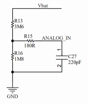

I want to read the Vdd (link to VDDA) of my board with the ADC in a STM32L072. I try read it through a divider bridge or through VrefInt, and both give me a value far below the voltmeter value.

In both cases, I have too small voltage, I measured on a voltmeter, I have ~1.1V on the divider bridge, and 3.3V on Vdda (link to Vdd through a self).
Where is my mistake ? Is there something to check ?

> 3M6
> 1M8

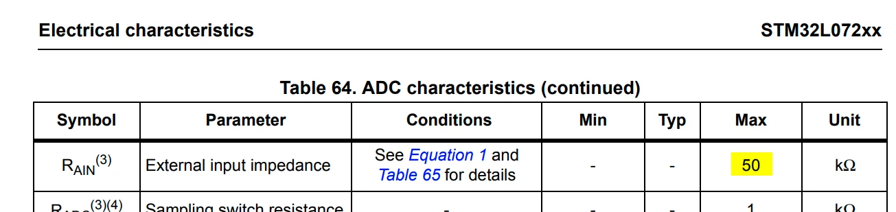

Your resistors are much too high. It's dragging down that net during the sample time. Increasing C27 will mitigate the issue. You would also need to ensure the cap is fully charged. Or, since the drop should be about the same percentage of the value each time, you could add a calibration factor to estimate the real value. You also have charge injection happening which can be significant when your impedance is so high.
ADC calibration is per-ADC, not per channel, and because VREFINT is measured correctly, it suggests your ADC is performing fine.
Multimeters use a longer sampling time and have a much higher impedance when voltage testing compared to the ADC.

About the divider bridge, a picture is more efficient than words (analog_in is linked to PA1):0693W00000KZseeQAD.pngAbout the calibration, do I need a calibration per channel ? VrefInt and channel1 have not the same offset apparently.
