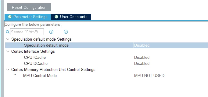

I believe that I have tried almost everything now, not getting anywhere.
My default settings was MPU NOT used and cache disabled and Speculation Disabled.
Would Any MPU setting improve compared to this?
What else can I do?

sCommand.InstructionSize = HAL_OSPI_INSTRUCTION_8_BITS;
sCommand.InstructionDtrMode = HAL_OSPI_INSTRUCTION_DTR_DISABLE;
sCommand.AddressMode = HAL_OSPI_ADDRESS_8_LINES;
sCommand.AddressSize = HAL_OSPI_ADDRESS_24_BITS;
sCommand.AddressDtrMode = HAL_OSPI_ADDRESS_DTR_DISABLE;
sCommand.AlternateBytesMode = HAL_OSPI_ALTERNATE_BYTES_NONE;
sCommand.DataMode = HAL_OSPI_DATA_8_LINES;
sCommand.DataDtrMode = HAL_OSPI_DATA_DTR_DISABLE;
sCommand.DQSMode = HAL_OSPI_DQS_ENABLE;
sCommand.SIOOMode = HAL_OSPI_SIOO_INST_EVERY_CMD;
sCommand.Address = 0;
sCommand.NbData = 1;
/* Memory-mapped mode configuration for Linear burst write operations */
sCommand.OperationType = HAL_OSPI_OPTYPE_WRITE_CFG;
sCommand.Instruction = LINEAR_BURST_WRITE;
sCommand.DummyCycles = DUMMY_CLOCK_CYCLES_SRAM_WRITE;
if (HAL_OSPI_Command(&hospi1, &sCommand, HAL_OSPI_TIMEOUT_DEFAULT_VALUE)!= HAL_OK) {
Error_Handler();
/* Memory-mapped mode configuration for Linear burst read operations */
sCommand.OperationType = HAL_OSPI_OPTYPE_READ_CFG;
sCommand.Instruction = LINEAR_BURST_READ;
sCommand.DummyCycles = DUMMY_CLOCK_CYCLES_SRAM_READ;
Error_Handler();
/*Disable timeout counter for memory mapped mode*/
sMemMappedCfg.TimeOutActivation = HAL_OSPI_TIMEOUT_COUNTER_ENABLE;
sMemMappedCfg.TimeOutPeriod = 100;
/*Enable memory mapped mode*/
if (HAL_OSPI_MemoryMapped(&hospi1, &sMemMappedCfg) != HAL_OK) {
Error_Handler();
Hope somebody can help with this
