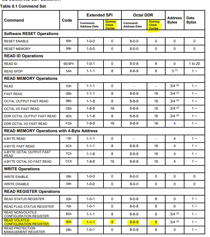

Hello @aco990 ,
Please make sure that when reading volatile register 0x85h the dummy cycles are "8" not "0" referring to the memory datasheet table 8.1.

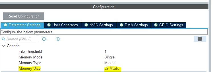

Could you please check the memory size. According the memory datasheet the the IS25LX032 memory size is 32Mbits.
The last version of STM32CubeMX 6.12 for windows uses the Bits unity for memory size. So, the memory size must be configure to 32MBits in STM32CubeMX. Please take a look at this post to check the memory size.

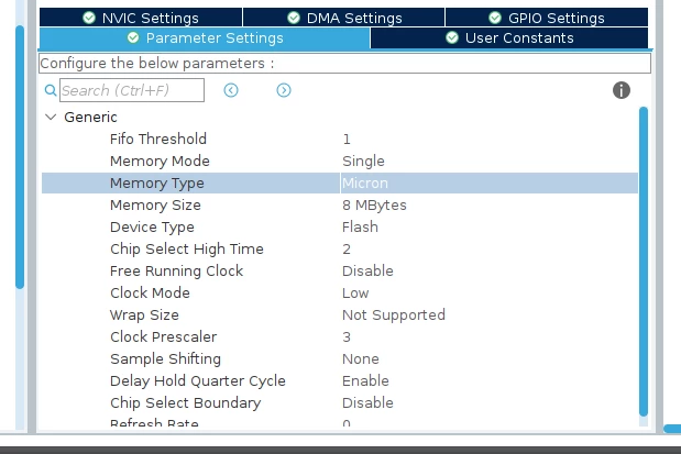

aco990Author
August 12, 2024
Hi Kaouthar,
the memory size is correct, it's 8MBytes. I am using the IS25LX064 Flash which has 64Mbits (8Mbytes).
I set the dummy cycles to 8 for reading the volatile config register but still the same error.
Thank you!

Could you please use the latest version of STM32CubeMX 6.12.0 because there is a bug with the older version of  STM32CubeMx and STM32CubeIDE toolchain as mentioned here.
Could you please check the DEVSIZE field of OCTOSPI_DCR1.
