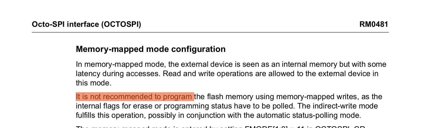

I use the IS25LX064 OctoSPI Flash memory with the STM32H573 and i can write and read from memory using direct mode. In memory mapped mode i can read the flash correctly for 0x90000000 but writing at 0x90000000 using memory mapped mode causes a hard fault with precise error at 0x90000000.
Does that mean it's not possible to write to the flash in memory mapped mode? RM0481 says:
Line 44 fails. Line 34 and 35 are working fine. And if i write using line 34 and then enable the memory mapped mode the read sequence from line 54 works fine, which means the memory mapped mode configuration is ok.

	/*It is not recommended to program the flash memory using the memory-mapped writes:
	the indirect-write mode fulfills this operation. See RM0481 Rev 2 section 23.4.15*/

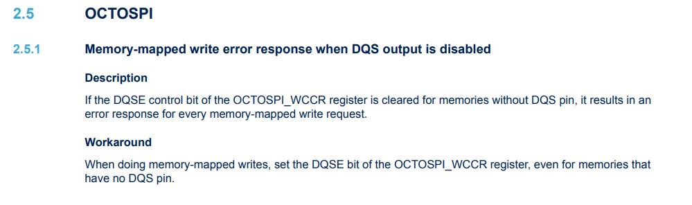

Hello @aco990 ,
Is the DQS output is disabled?
Could you please take a look at the errata sheet and precisely 2.5.1 Memory-mapped write error response when DQS output is disabled.
May OSPI_NOR_MemoryMapped can help you. This example describes how to erase a part of an OSPI NOR memory, write data in memory-mapped mode and access to OSPI NOR memory in memory-mapped mode to check the data in an infinite loop and runs on STM32H573IIKxQ devices.

I wouldn't anticipate this working, and I don't see a template setup for the write operation. Writes tending to have specific alignment and buffer size expectations, write enable prior, and waiting for completion after. The peripheral isn't that complex.
RAM devices might have less limitations.
Use HAL_xSPI_Abort() to terminate Memory Mapped operation.

Hello @KDJEM.1,
looking at the schematic the DQS Pin of the flash is not used. But enabling DSQ for write operations as explained in errata sheet 2.5.1 fixed the problem.  I can now write in memory mapped mode without any errors.
