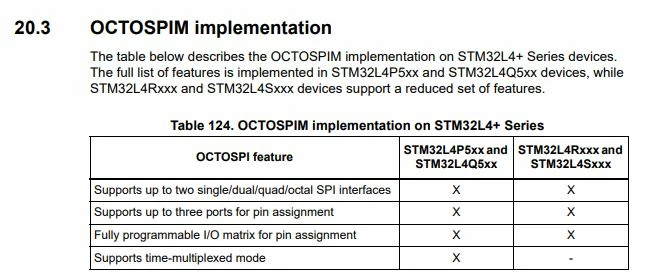

Octospi multiplexed hyperbus on STM32L4R9 with STMCubeMX
Hi
According to the datasheets, the STM32L4R9 LQFP100 devices should be able to support a multiplex hyperbus ram/flash device. (for example the cypress S71KSS12SCO)
But in STM32CubeMX, I'm unable to select the multiplexed hyperbus mode. I notice that I can with other devices like the STM32H7
Is this a problem with STM32CubeMX or am I not understanding the constraints and multiplexed hyperbus isn't supported on these devices after all?

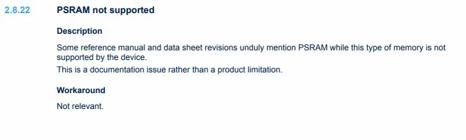

In fact, the PSRAM HyperRAM is available in the STM32L4R9-Eval, but due to the OCTOSPI limitations with PSRAMs, there is no longuer support OCTOSPI PSRAMs as described in the erratasheet.

The multiplexed mode is not supported for STM32L4R/Sxxx series.
You can check the "Table 124. OCTOSPIM implementation on STM32L4+ Series", in the STM32L4+ Reference Manual (RM0432) described that the multiplexed mode is not supported for STM32L4R/Sxxx.
Note that the OCTOSPI-PSRAM memories (including HyperRAMs) are not supported in the STM32L4R/Sxxx products.
0693W00000Bbof2QAB.jpgFor more details, please have a look at the STM32L4Rxxx / STM32L4Sxxx errata sheet.
So, It's recommended to use Parallel PSRAM memories with FMC or to switch, if possible, to a STM32L4P5/Q5xx product which supports OCTOSPI PSRAM memories.

But what about the hyperram? I do need the MIPI-DSI-PHY. I assume that hyperram is supported in the stm32l4r9 because of the dev board, and some threads I've seen, but you've got me worried now!
jim
Imen.DBest answer
Jun 24, 2021 11:18 AM UTC
Imen
