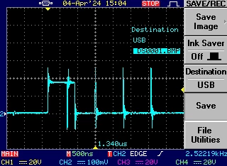

I'm trying to understand the OCTOSPI peripheral on my STM32L4P5. I'm new to STM32, but old in embedded. Particularly, I need to know/affect the idle level of the data line of the OCTOSPI. I thought that the last transmitted bit would remain there...
But no, I encountered a really weird behaviour. See for yourself. I created a simple program periodically test sending 16 bytes. The OCTOSPI is set to transmit on 1 data line, data only, no instruction, no address.
Test A:
while (1)
HAL_Delay(1);
OCTOSPI1->DR = 0xFFFEFFFF;
OCTOSPI1->DR = 0x00010000;
Result: The idle level is High:

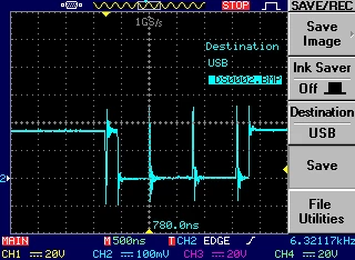

Test B:
while (1)
HAL_Delay(1);
OCTOSPI1->DR = 0xFFFEFFEF;
Result: The idle level is Low:
The difference between A and B is one bit: the MSB of the lowest byte of the first write. It is the first transmitted bit, if I understand correctly.
Can somebody explain this? How can that bit affect the idle level?
I think I'm missing something substantial here.
