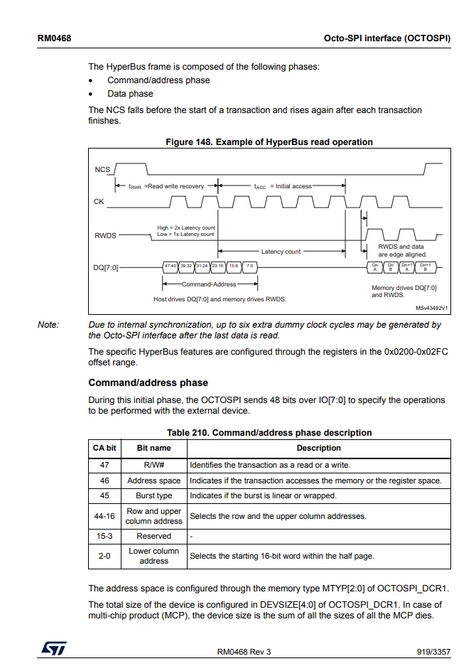

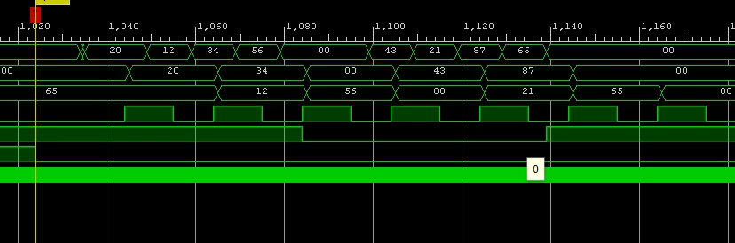

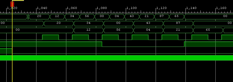

When I write to address 0x91234568 (0x90000000) is octospi1 base
with the data of 0x87654321 then i get following sequence in hex:
20 12 34 56 00 04 43 21 87 65
The Data is easy, that's just different order 43 21 87 65 instead of 87 65 43 21
The 20 seems to be CMD
The Address (in correct order) 12 34 56 (but then always 00 00 or 00 04) as the last, I seem to lack the last nibble of the Address.  The RWDS Seems a bit early.
if I Change to 0x91234560  then  the same 20 12 34 56 00 00 43 21 87 65, just with out the 04

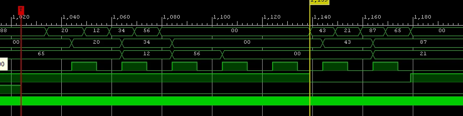

If I write at 0x91234564 I get 4 extra bytes before RWDS.
20 12 34 56 00 00 00 00 00 00 43 21 87 65, But now the RWDS is accurate
If I write at 0x9123456C I also get the 4 extra bytes before RWDS, now with 04.
20 12 34 56 00 04 00 00 00 00 43 21 87 65, and the RWDS is accurate
If I write at 0x91234566 I also get the 6 extra bytes before RWDS, now with 00.
if I write on uneven addresses then bytes a masked with RWDS.
There seems to be a quite clear pattern, that I first discovered while writing this message, but again, it is a bit difficult.

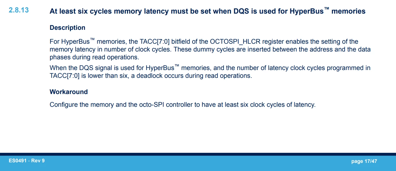

Could you provide more details? Which STM32H7 MCU and HyperRAM memory are you using?
Could you please share the memory datasheet?
I advise you to take a look at the STM32H7 errata sheet and check the OCTOSPI errata and the workaround.
If you use the STM32H735 please note that at least six cycles memory latency must be set when DQS is used for HyperBus™ memories (sHyperBusCfg.AccessTime = 0; should be sHyperBusCfg.AccessTime = 6;)
May this example "OSPI_HyperRAM_MemoryMapped" can help you.

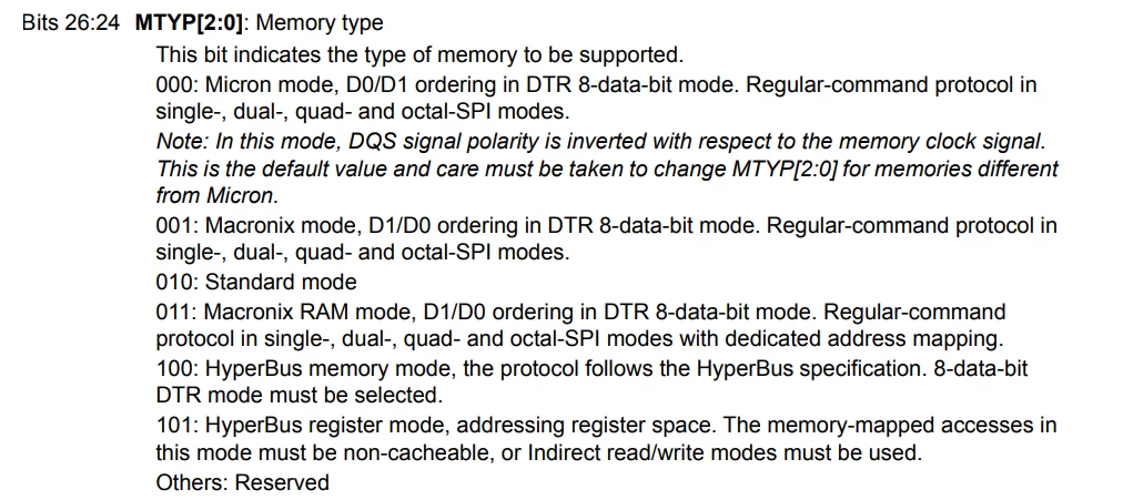

I want to use the OctoSpi for communication with a FPGA, I will write the VHDL for the interface myself so I'm not bound to any memory interface type, but I want to have the FPGA memory mapped
will that work with the other types like:
HAL_OSPI_MEMTYPE_MICRON
HAL_OSPI_MEMTYPE_MACRONIX
HAL_OSPI_MEMTYPE_APMEMORY or
HAL_OSPI_MEMTYPE_MACRONIX_RAM ?
Where do I find information on how-to setup this?
I want the interface to work with least possible latency
Kristian Vang
KDJEM.1
August 14, 2024
Hello @Kvang ,

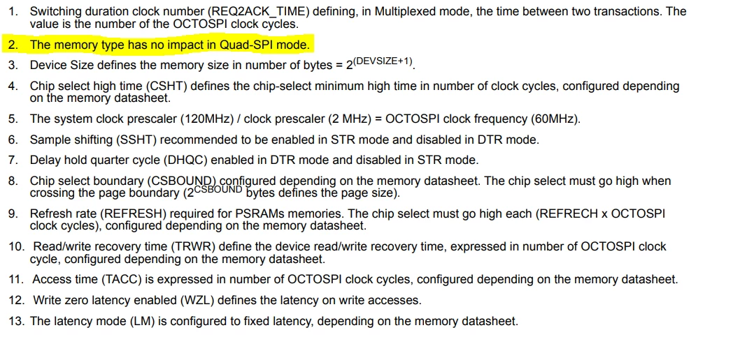

For communication with an FPGA using the OctoSPI interface, you can choose any of the following memory types, depending on your specific requirements:
  • HAL_OSPI_MEMTYPE_MICRON: This mode is typically used for Micron memories (and compatible memories) and follows the D0/D1 ordering in DTR 8-data-bit mode.
  • HAL_OSPI_MEMTYPE_MACRONIX: This mode is used for Macronix memories (and compatible memories) and follows the D1/D0 ordering in DTR 8-data-bit mode.
  • HAL_OSPI_MEMTYPE_APMEMORY: This mode is used for AP Memory devices.
  • HAL_OSPI_MEMTYPE_MACRONIX_RAM: This mode is used for Macronix RAM and includes dedicated address mapping.
Note that the memory type has no impact in Quad-SPI mode as mentioned in AN5050.
Thank you.

Hi @Kvang ,
Thank you for coming back to the community and glad to know that the initial issue is solved.
I didn't quite understand your new questions and your requests.
For HyperBus protocol, during this initial phase, the OCTOSPI sends 48 bits over IO[7:0] to specify the operations
to be performed with the external device. And Bit 47 identifies the transaction as a read or a write.
Please take a look at RM0468 section 25 Octo-SPI interface (OCTOSPI) may help you.
