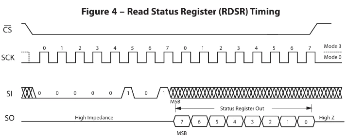

Hi everybody,
I'm trying to configure the OCTOSPI1 bus as Single-SPI to read the status register of an external memory (MRAM).
What I expect to see on the scope
0693W00000JP5s9QAD.pngWhat I really see:
  1. The MCU sends the comand (0x05) on the SI line, generates 8 clock cycles and pulls down the /CS line.
  2. IO1 is always 1.
Please, find below more details about the setup and code (ask me for more detais if needed):

JoseFdezBest answer
February 9, 2022
We have just found a board connection issue in the MRAM side.
Maybe the problem it's there.
The question can be closed.
Thank you.
