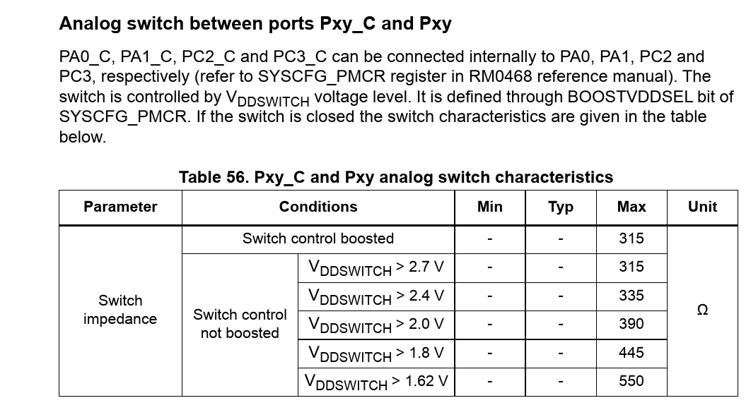

AScha.3
August 10, 2024
>Yes I am using PC2_C and PC3_C - is there something I must take into consideration?
YES. The xx_C are not good to drive hi-speed signals :
ds:
So you have about 400 ohms source resistance here +
xx_C should be used only for ADC input ...
and should not drive more > 1mA , otherwise you might kill it . (I did - so i know - with just the clock to a TFT on a xx_C pin. Testing TFT with 4MHz clock was ok, but then i switched to 16MHz - 1 screen written, then pin died. )
So dont use these pins for hi-speed signals - they cannot drive it. If you cannot change it now, try with
ed : low speed setting (400 ohm in series ! ) , just to verify your design is working. (maybe 2 MHz clock...)

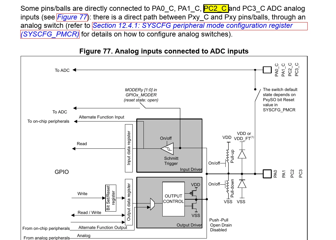

AScha.3
August 12, 2024
Just looking at ds, pin list, at pins PC2+3 :
If "standard" pin, standard timing - as expected.
If something other, like _a -- other timing, need look at details for this kind of pin.
Southbranch
Senior
August 13, 2024
Thank again,
Could you please elaborate a bit.
I have checked RM0468 but I can’t find anything explicitly stating that PC2_C/PC3_C could not be used for high speed communication.

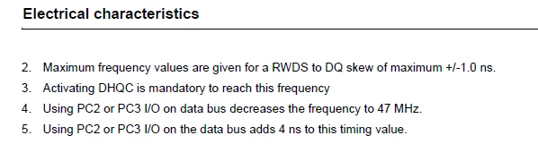

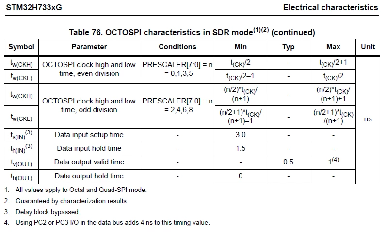

LCE
Principal II
August 13, 2024
Check the datasheet not the RM, search for "PC2".
Datasheet of H733, should be the same for H723/H725.
See note 4.
Even worse, see again note 4 for HyperBus, max freq with PC2 is 47 MHz:
Dear ST, this should not be in smallest print in some footnotes, but bold and BIG in each mentioning of every use outside of analog input.
There was no CubeMX warning?
