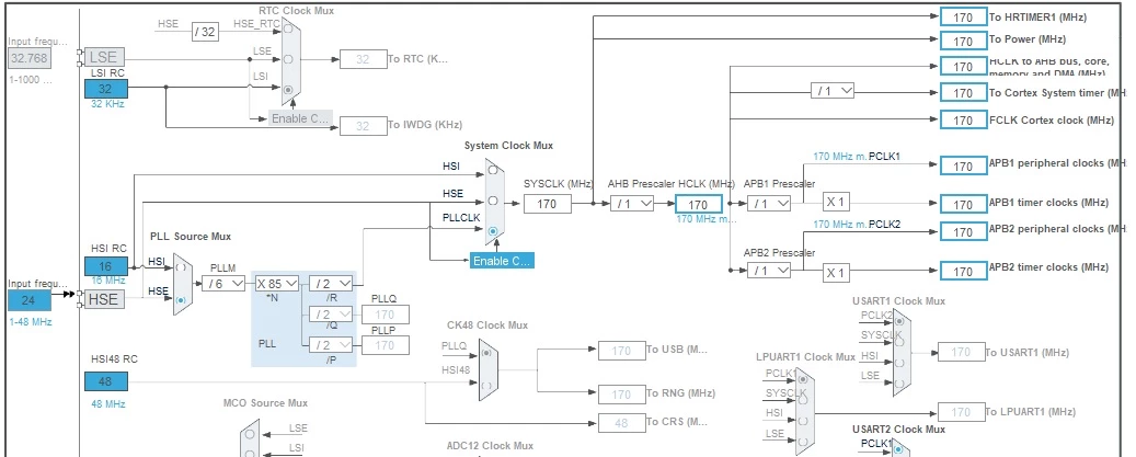

Hi, everyone,
Checking the TX signal form MCU to the computer made me reach the conclusion that there was in fact a clock mismatch in the MCU. The bit duration of the sent info was about 0.438ms, which translates in roughly 2280 baudrate.
I am investigating the clock configurations and cant´t find anything wrong. It is as follows:
void SystemClock_Config(void)
 RCC_PeriphCLKInitTypeDef PeriphClkInit = {0};
 HAL_PWREx_ControlVoltageScaling(PWR_REGULATOR_VOLTAGE_SCALE1_BOOST);
 RCC_OscInitStruct.OscillatorType = RCC_OSCILLATORTYPE_HSE;
 RCC_OscInitStruct.HSEState = RCC_HSE_BYPASS;
 RCC_OscInitStruct.PLL.PLLSource = RCC_PLLSOURCE_HSE;
 RCC_OscInitStruct.PLL.PLLM = RCC_PLLM_DIV6;
 RCC_OscInitStruct.PLL.PLLN = 85;
 RCC_OscInitStruct.PLL.PLLP = RCC_PLLP_DIV2;
 RCC_OscInitStruct.PLL.PLLQ = RCC_PLLQ_DIV2;
 RCC_OscInitStruct.PLL.PLLR = RCC_PLLR_DIV2;
 Error_Handler();
 RCC_ClkInitStruct.APB1CLKDivider = RCC_HCLK_DIV1;
 RCC_ClkInitStruct.APB2CLKDivider = RCC_HCLK_DIV1;
 if (HAL_RCC_ClockConfig(&RCC_ClkInitStruct, FLASH_LATENCY_4) != HAL_OK)
 Error_Handler();
 /** Initializes the peripherals clocks
 PeriphClkInit.PeriphClockSelection = RCC_PERIPHCLK_USART2;
 PeriphClkInit.Usart2ClockSelection = RCC_USART2CLKSOURCE_PCLK1;
 if (HAL_RCCEx_PeriphCLKConfig(&PeriphClkInit) != HAL_OK)
 Error_Handler();
Also, I have attached a print screen of the Clock Configuration Diagram of the .ioc file and it seems to match the configuration function. I am using this 24MHz oscillator: https://pt.mouser.com/ProductDetail/ABRACON/ASE-24000MHZ-LC-T?qs=ShQ8XZQtgRscJew7eOA%2FgA%3D%3D
I am really confused as to why my USART2 configuration function returns the PCLK1 as being 16MHz, instead of 170MHz. I think the problem might lay here. Any clue on this?
BTW, a few months ago I realized the same problem on the High Resolution Timer, in which the periferal clock was 16MHz, instead of 170MHz, as it was supposed.
Thanks in advance. Kind regards,
Pedro Machado

[SOLVED]
It turned out to be the case that the oscillator was broken. A new oscillator solved the problem.
