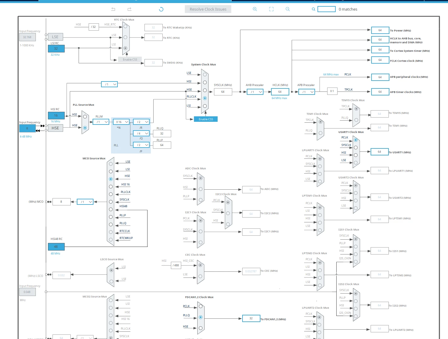

This is the clock topology I am using:
As you see the CCS is disabled and the CAN clock and the system clock is running on 64 MHz.

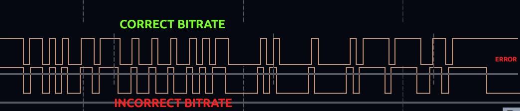

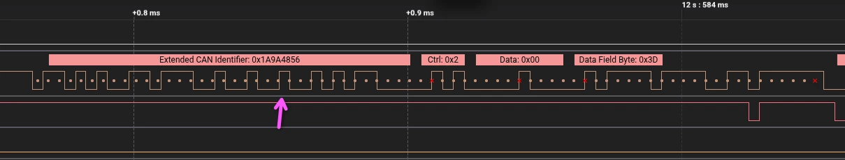

In some cases my CAN frames are transmitted with a bitrate faster than expected:
The edges some times falling totally to the sampling points, the calculated bit times are lower than 4 us:
Putting the correct and incorrect frames the difference is more visible:

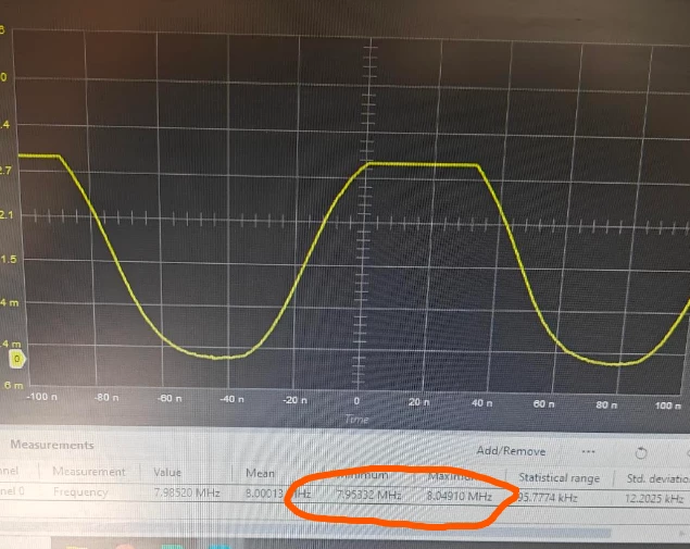

I have tried to route the HSE to the MCO to see how stable is it, but I have not detected any deviation which could cause this deviation.

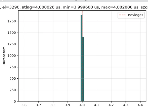

I also tried to run an overnight test to send a CAN frame continuously and capture the waveform and calculate back the bit times are quite identical:

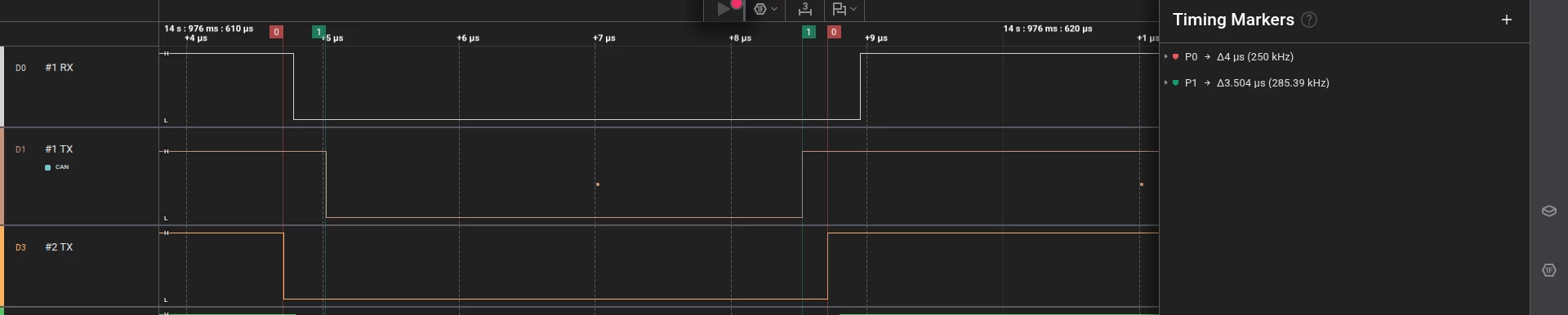

We made some scripting with the Saleae logic to see if the first node transmitting during arbitration ever fails to met the exact 4 us and no, it was always 4 us like this:
My instinct said if the shortened durations would be PLL glitch related then the first sensor waveform would be the most affected.

While I don’t know the G0 MCU in detail, but I would recommend to configure / enable MCO, and measure this output the same way as the CAN signal.
martonmiklos
Senior
Sep 1, 2026 6:53 AM UTC
This was my very first idea as I have written:
I have tried to route the HSE to the MCU to see how stable is it, but I have not detected any deviation which could cause this deviation.

waclawek.jan
Sep 1, 2026 12:18 PM UTC
Due to the resynchronization mechanism of CAN, if several parties start to transmit simultaneously, you can’t determine which of them is deviant and why, purely by observing the bus. You’d need to observe all participant’s Tx, simultaneously, too.
