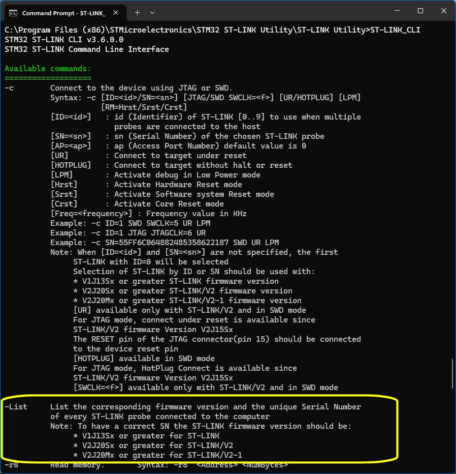

If you just run the command line tool, it gives you the list of options:
eg,
> ST-LINK_CLI -list
STM32 ST-LINK CLI v3.6.0.0
STM32 ST-LINK Command Line Interface
--- Available ST-LINK Probes List ---
ST-LINK Probe 0:
 SN: 066DFF353638425043092643
 FW: V2J44M0
ST-LINK Probe 1:
 SN: 52FF6E066767564811211767
 FW: V2J42S7
