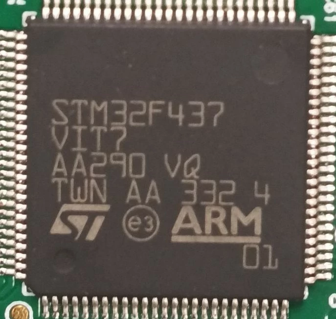

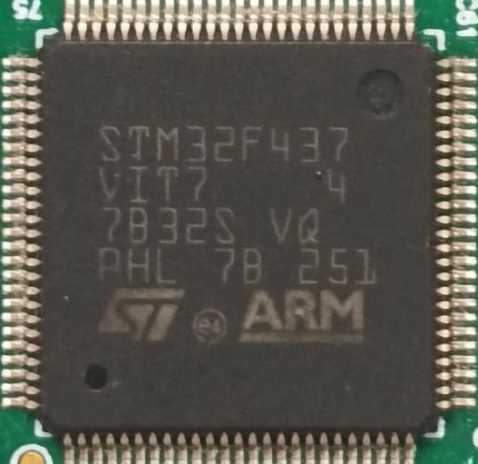

The only difference I can see is that the label imprinted on the STM32 controller is different for these two batches:
Batch1:
Batch2:
Any help is appreciated.

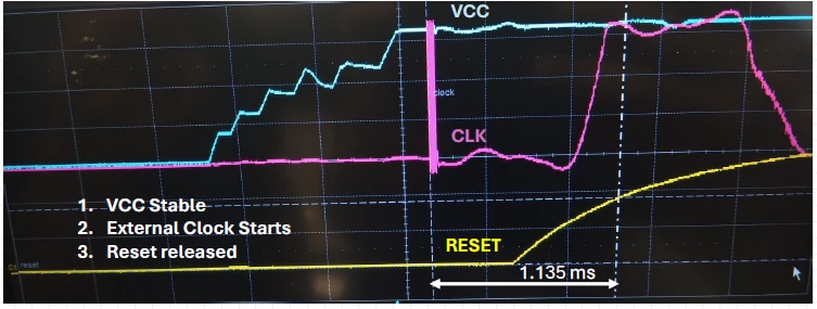

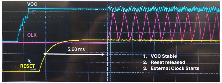

sameekshAuthor
June 5, 2024
Hi Danish,
The things you pointed out was on point.
Here are the waveforms of VCC,Reset and clock for both the batches:
Batch1:
Batch2:

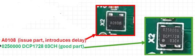

As you can see form these snippets, in batch1 the STM is coming up before the clock. Since the HSE is not available it utilizes the HSI for the booting up. That is why it boots up slowly. Where as in the batch2 boards, HSE is utilized for booting.
This happened because of the faulty 25MHz oscillator. When we physically removed the oscillator from batch2 and placed on batch1 boards, it too started booting quickly.
Thank you for guiding me in this direction. It really helped to find the root cause and mitigate it.
