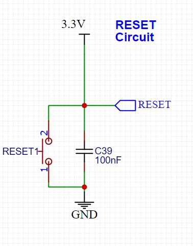

NVIC_SystemReset(); works with STM32F103C but not with STM32F103R
I tried the same code on both microcontrollers, but STM32F103RET6 freezes with NVIC_SystemReset(); Can you help me please?

What hardware? How is NRST connected? How is BOOT0 connected?

Reset can fail on these MCU's if the pin is driven HIGH externally.
It is both an input and output pin, and clamped to ground open-drain style but the NVIC_SystemReset() or the POR triggering on the VDDA threshold level.
External reset circuits are expected to clamp to ground to reset, but otherwise let it float, and have the on pin pull-up get it to the high state.
Make sure BOOT0 and BOOT1 aren't floating, these can cause other code to start, especially in circuits where the power supply has a slow rise time.

This is connection of reset pin. As I said, everything works perfectly, the only thing is software reset with NVIC_SystemReset(); 0693W00000aI4MuQAK.png0693W00000aI4M1QAK.png

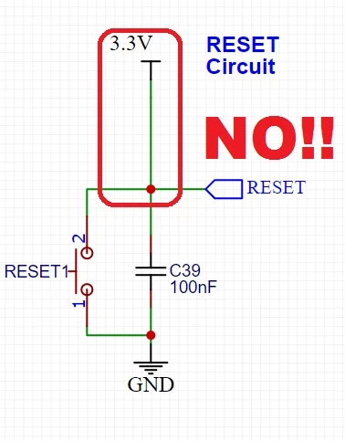

You definitely have a mistake in the RESET drawing, because when you press the reset button, it makes a fat short circuit between 3.3V and GND. Or do you really have Reset permanently connected to 3.3V?

The previous iteration/schematic had a pull-up

I have tried take off jumpers, but it didnt help.

Thank you Peter for your answer. Boot pins are connected to jumpers like on bluepill board, to change logic 0 and 1. I will test it, where i s aproblem with booting.
