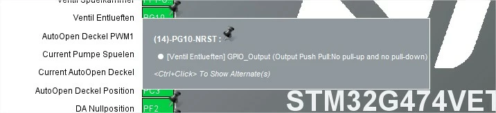

    dominik
    dominikAuthor
    Senior
    Nov 13, 2020 1:04 PM UTC
    Tesla DeLorean
    Guru
    Nov 13, 2020 1:20 PM UTC
    Well I suppose that could complicate things. Not sufficiently read into the G4's to know the potential consequences of doing that.
    You'd perhaps want to find a FAE to talk too, or file a Online Support Request to see if there is any gotchas. @Amel NASRI​ @Imen DAHMEN​
    Check also errata
    You might try configuring the pin as an INPUT + PULL-UP prior to the NVIC_SystemReset()
    >>But it works like 70-80% of the updates... Is there a precompiler setting or something to check? I'm using IAR.
    Not sure it is something resolvable with a compiler setting

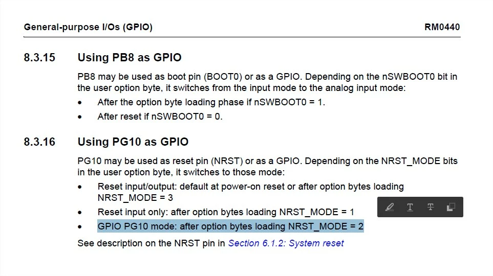

    dominik
    dominikAuthor
    Senior
    Nov 13, 2020 2:03 PM UTC
    I saw this entry, Its not working correctly but I saw when I connect with multi meter to measure the voltage level on this PIN the Core is getting resetted even if the impedance is really high...0693W000005BKZrQAO.jpg
    dominik
    dominikAuthorBest answer
    Senior
    Nov 13, 2020 2:18 PM UTC
    @Community member​  I think the Option bytes was the solution, I changed them with the STM32 Cube Programmer the NRST Mode to 2, now its working and I can use PG10 as Push/Pull output
