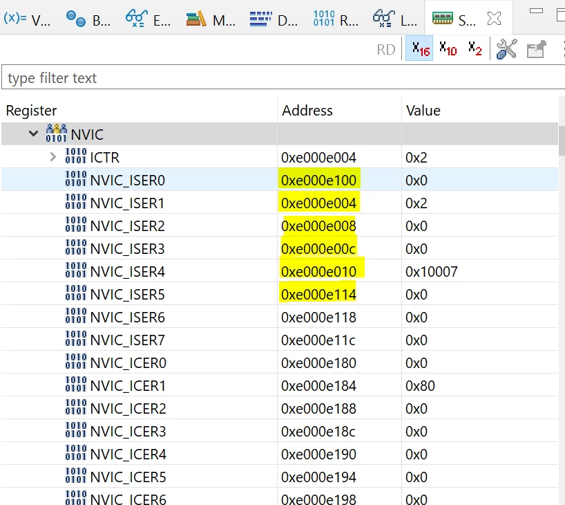

NVIC register base address problem
  • August 13, 2021
  • 1125 views
0693W00000D2Q3CQAV.pngIs there somethings wrong with my STM32F407 Discovery board, the base address of NVIC register display in Debug section is very strange! Please give me some advise in this case
2 replies
August 13, 2021
Are you on the latest versions?
Longstanding issue, but supposed to be fixed in the latest versions.
https://community.st.com/s/question/0D53W00000qyqH9SAI/nvic-iserx-registers-address-are-wrong-in-stm32f446re
Tnguy.2
Tnguy.2Author
August 13, 2021
@TDK​ Thanks for your suggestions. I am using version 1.6.1 . I think it caused to could not enable interrupt for peripherals like UART, I2C,...I will try your guide.
