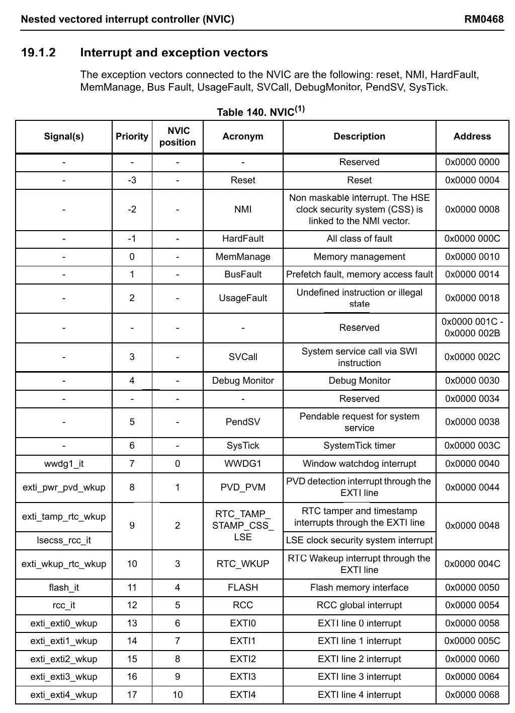

Where can i get the information about which interrupt is activated for each of those bits? How can such information be so hard to find? Cant find it on the ARM website! Just the information, that it shows activated interrupts, which is essentially useless... *facepalm*

Easier to get this information from the VECTACTIVE field in SCB->ICSR.
LSB of IABR0 corresponds to "NVIC position" 0 which is WWDG1 here. Goes up from there, 32 per register.
13 of them don't have "NVIC position" values because they're system interrupts and not reported anywhere in IABR.

Interrupts past the first 16 are vendor-defined. They are the in the reference manual of the relevant chip. For example:

I see 13 without a NVIC position. I still dont know which bit corresponds to which interrupt.

Enumerate the entire table..
Architecturally:
256 bits on IABR [0..7]
16 System Handler
240 IRQHandlers (assigned by implementer, so STMicro for STM32's)
16 + 240 = 256
Divider the Address in Vector Table by 4
Check IABR0.15 is asserted whilst in SysTick_Handler
Check IABR0.26 is asserted whilst in EXTI4_IRQHandler
