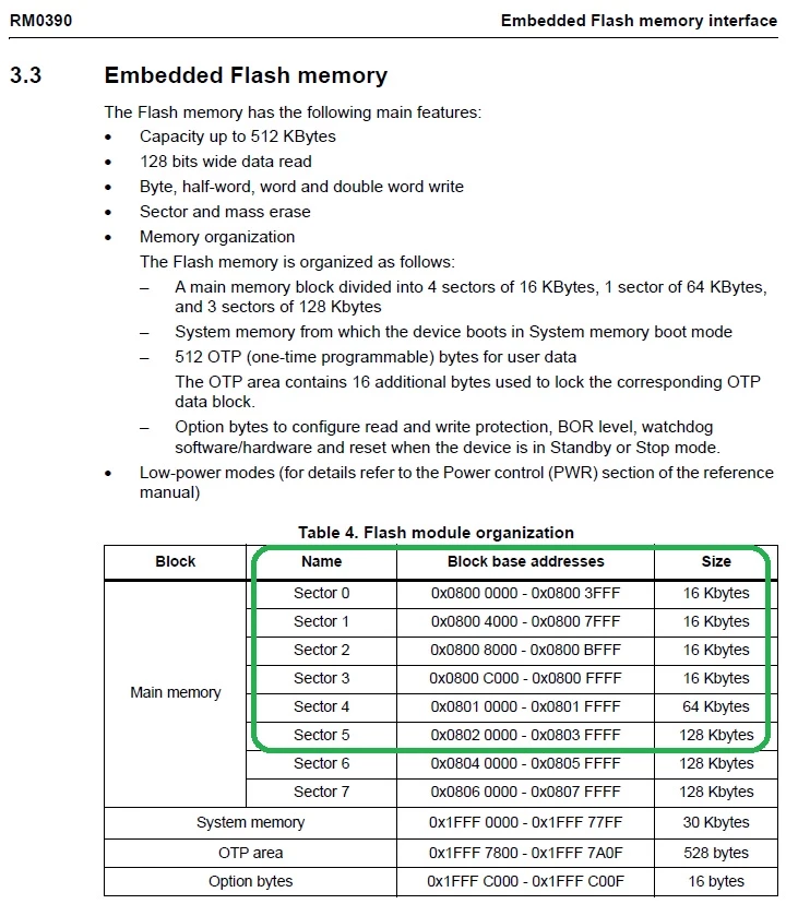

number of sectors in the stm32f446rc flash memory
How many sectors does the flash memory of stm32f446rc has and what is the size of each sectors ?

Same die, up to 512KB

KnarfB
September 1, 2021
RM0390
Reference manual
STM32F446xx advanced Arm®-based 32-bit MCUs
is your friend.
AR.7
AR.7Author
September 2, 2021
That Reference manual has details for 512 KB flash memory only ...not for 256 KB flash memory.

September 2, 2021
